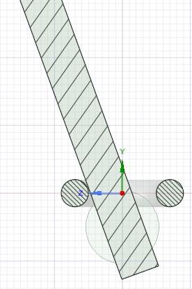

      Continue using Universal joints.
      In the image below, I have removed the ball on the end of the shaft. It serves no purpose. Instead I have lengthened the shaft so that there is a large overlap of the shaft and the toroid. I show where the ball used to be. You can see there is a much longer shaft surface to make contact with the toroid. The U-joint has its origin on the shaft, at the center of where the ball used to be.
      There is a Fixed Joint between the toroid and the triangular base (not shown).

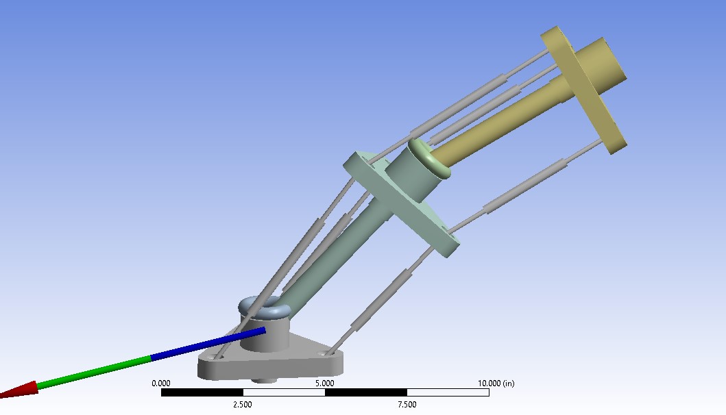

      Hello Mr. Newman,
      Thank you for your reply and the drawing. I apologize for the late reply. I was trying out a few things and ANSYS was taking up almost all the CPU power. Hence, each simulation took sometimes about an hour or two.
      I tried it with the modification that you suggested. I did the RBD analysis for two modules and it still shows interference. Please find the attached image.
      I thought maybe increasing the stiffness of the springs would solve it. It does so some extent. In the above case, it was 80lbf/in for the lower springs and 60 for the upper ones. I changed it to 160 and 100 and the solver didn't complete the analysis. It stopped after step 11 of 25. I am out of ideas and can't pin point what/where the actual issue lies.
