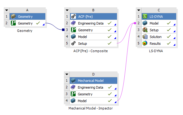

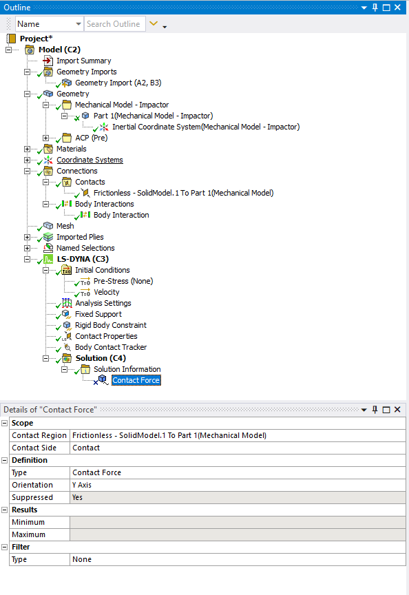

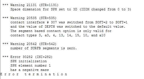

      Hi. I am trying to run a simulation of low velocity impact on composite in LSDYNA, ANSYS Workbench. A composite body (flexible) modeled in ACP and a impactor body (rigid) modeled in mechanical model in present here. I am getting SPH errors.
      If I convert the impactor to a flexible body with high stiffness the simulation runs well though I will have to validate the results. But changing to rigid body is causing this SPH errors. I am not familiar with this error and cant figure out what's causing them.
      I can consider SPH but even then there is a negative mass error. All the pictures are attached here.
      Any help will be much appreciated. Thanks.
    • Neetu Jha
      Hi, *MAT_RIGID is not supported by SPH thats why this error comes!
