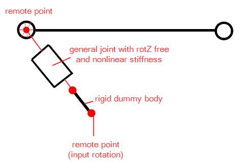

      So far, I have managed to implement the nonlinear stiffness characteristic by using the general joint with all DOFs but rotZ fixed between a dummy rigid body and the actual link scoped by remote point. I will then apply the input rotation condition to the rigid cylinder and the rotation will transfer to the actual link as a moment including the nonlinear stiffness. Problem is, that if I use the general joint instead of a revolute joint, I lose the option of specifying a friction to the joint.

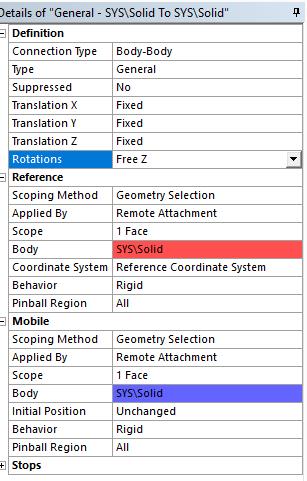

      Please show the General Joint details.
      Did you set Z rotation = 0 for that joint?  That is required so that the revolute can deliver the Z rotational freedom.
    • Mordrag
      Please see below the screenshot of general joint settings.

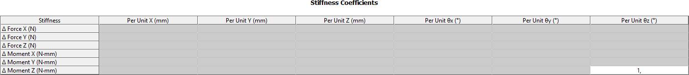

      I set all DOFs equal to 0, except for rotZ which is kept free to allow relative rotation, also stiffness can only be added for non-zero DOFs. Once stiffness is set to non-zero value, rotation is transfered between connected bodies with finite value of stiffness (as opposed to fixed joint)

      The problem is, that stiffness for general joint (or any other joint) can only be defined for DOFs which are set to free (that makes sense to me). Hence I need to have the free Z-rotation in general joint definition to be able to input stiffness.
      • when stiffness is set to 0 in rotZ in general joint:
        •    rotation which goes into general joint from previous member results in M = 0 (M=k*phi)
      • when stiffness is set to non-zero value in rotZ in general joint:
        •    general joint provides moment according to M=k*phi
      The general joint with all rotations fixed does not provide any displacement flexibility and acts only as a redundant member by outputting the same rotation as was inputted in it.
