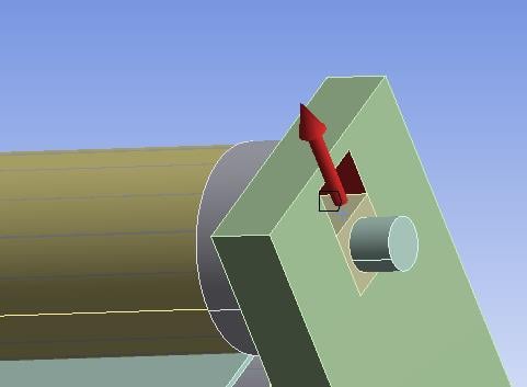

a) Are there any tools or technique to see either the surface is slipping or not? For example, contact tools at the result section have options to observe either the surfaces are sliding or sticking but not slipping?Â
b) Is there any way, I can make a connection like shown in the picture. There are a slot and a shaft. I want the free rotation of the shaft, as well as the free movement of the shaft in Vertical direction. I have tried using general joints but it doesn't allow me to rotate and if I use the revolute joint, it will fix the movement in a vertical direction. Is there any other combination(joints and contacts) we can use to make such connections?

You have two bodies, a fixed body with a slot feature and a second body that is a roller. Add a third body in the slot at the roller end. Put a translational joint between the slot body and the third body, and put a revolute joint between the third body and the roller. Now you have a roller that can translate up and down. However, this combination doesn't allow the roller to tilt away from horizontal without bending either the roller or the slot. You didn't mention if you want this freedom or not. If you replace the revolute with a spherical joint, now the roller is free to tilt in two directions as well as rotate.
April 29, 2019 at 10:50 pm
ksimulation
SubscriberThank you for your reply.
Yeah, I forget to mention that I wanted the shaft which is connected to the third body tilt as well. So, now, I used spherical joint so that shaft can tilt on the third body.
But now I would like to give the rotation to the shaft without affecting the tilt(spherical constraints), which means the center of rotation should change as shaft deforms and also rotate at same time. How can I do so? I couldn't give rotation using a spherical joint. If I use the body to ground revolute joint at the end edge of the shaft, that will constraints rotation/tilt which is created by spherical joint before.
In real design, the shaft is connected to the third body using plain bearing or bushing, so I am trying to get close to that constraint situation.Â
I have added the picture, how my design looks with a slot and spherical joints.Â
April 30, 2019 at 1:48 am
peteroznewman
SubscriberMechanical has Bearings that are appropriate for small deformations. You get to define three spring rates of the shaft to ground, horizontal, vertical and 45 degrees.
Try using a General joint to ground that only constrains rotation about the shaft axis and use a Joint Load to drive rotation.
