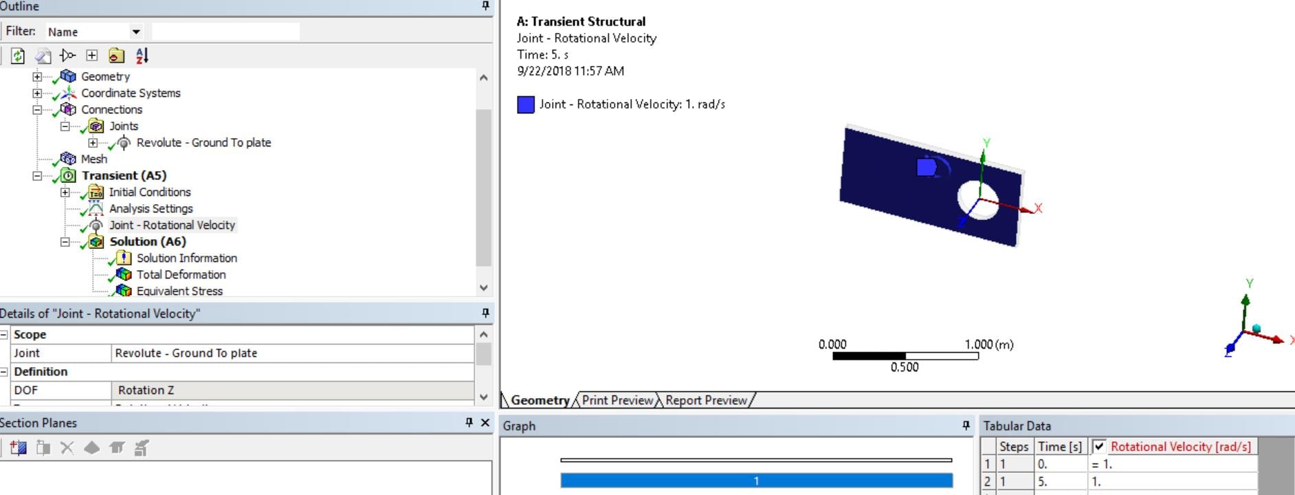

      Hello everyone I’m trying to give a rotational velocity by joint load to a revolute joint to rotate a flexible simple plate around a fixed point in Ansys transient structural. The problem is the part starts to expand instead of just rotating around the joint. Any idea why is this happening?

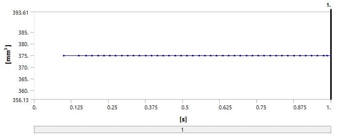

        I quickly tested this in 19.2 and I don't see any change in volume or expansion.
      the total volume of the part is constant.
      the high deformation is probably coming because of rigid body motion and the inertial effects. Look at the acceleration.

      Here are the changes I made to get a satisfactory rotation.
      • Turned Large Deflection On
      • Changed mesh to have two elements through the thickness of the plate
      • Changed the scope of the joint to be on the ID of the hole
      • Changed the Analysis Settings to be a 2 Step solution.
      • Changed the Joint Velocity to ramp up from 0 to 1 rad/sec from 0 to 1 seconds in Step 1.
      • The Joint Velocity is a constant 1 rad/sec in Step 2 from 1 to 5 seconds.
      • Set the Initial Substeps to 10 for Step 1.
      • Set the Initial Substeps to 40 for Step 2.
      The ANSYS 18.2 archive is attached.
