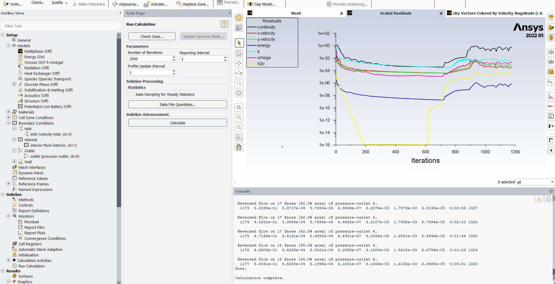

I have a huge backflow problem in my case.
I am considering flow through a cube (I made a 2d model because 3d didn't work but it didn't solve the problem).
My boundary conditions: 0.01 m/s velocity inlet and default pressure outlet. Two-phase flow (mixture or VOF), with gravity on. Unfortunately, as shown in the picture, I have a strong reverse flow, which gives non-physical results - because the inlet velocity is 0.01 m/s and the reverse flow is 0.6 m/s (I can't increase the velocity inlet)
I've tried extending the outlet, fine-tuning the mesh, setting a different operational density, but nothing works. Unfortunately, I have no idea what I can do and this is an important problem for me. (With gravity off, no problem.) It is interesting that gravity "destroys" the model even when the pressure values of my substance are constant.
Has anyone encountered such a problem? the continuity equation does not converge (i try hybrid and standard initialzation).https://drive.google.com/drive/folders/13e37e40V74l0dty0HNNc4sTRYqqp6WtZ?usp=sharing

July 31, 2023 at 3:25 pm
July 31, 2023 at 3:41 pm
Rob
Forum ModeratorThat's not ideal. Why are you using nitrogen & water vapour, with I assume oxygen as the third species? Air & vapour would be marginally more efficient.

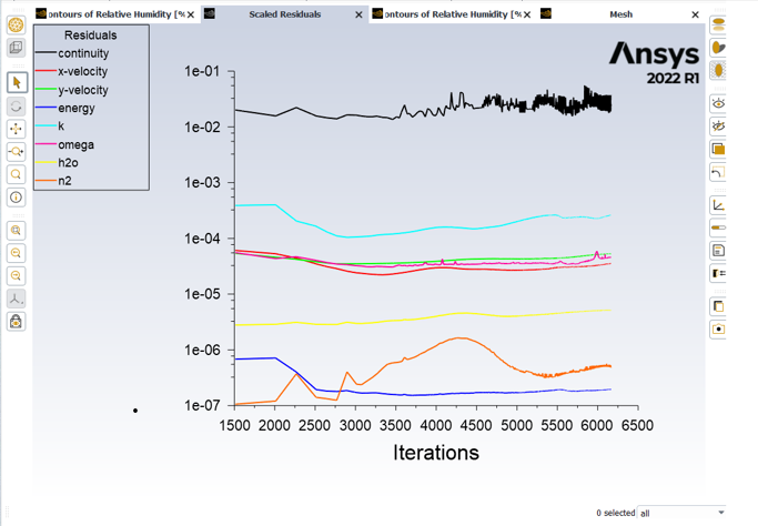

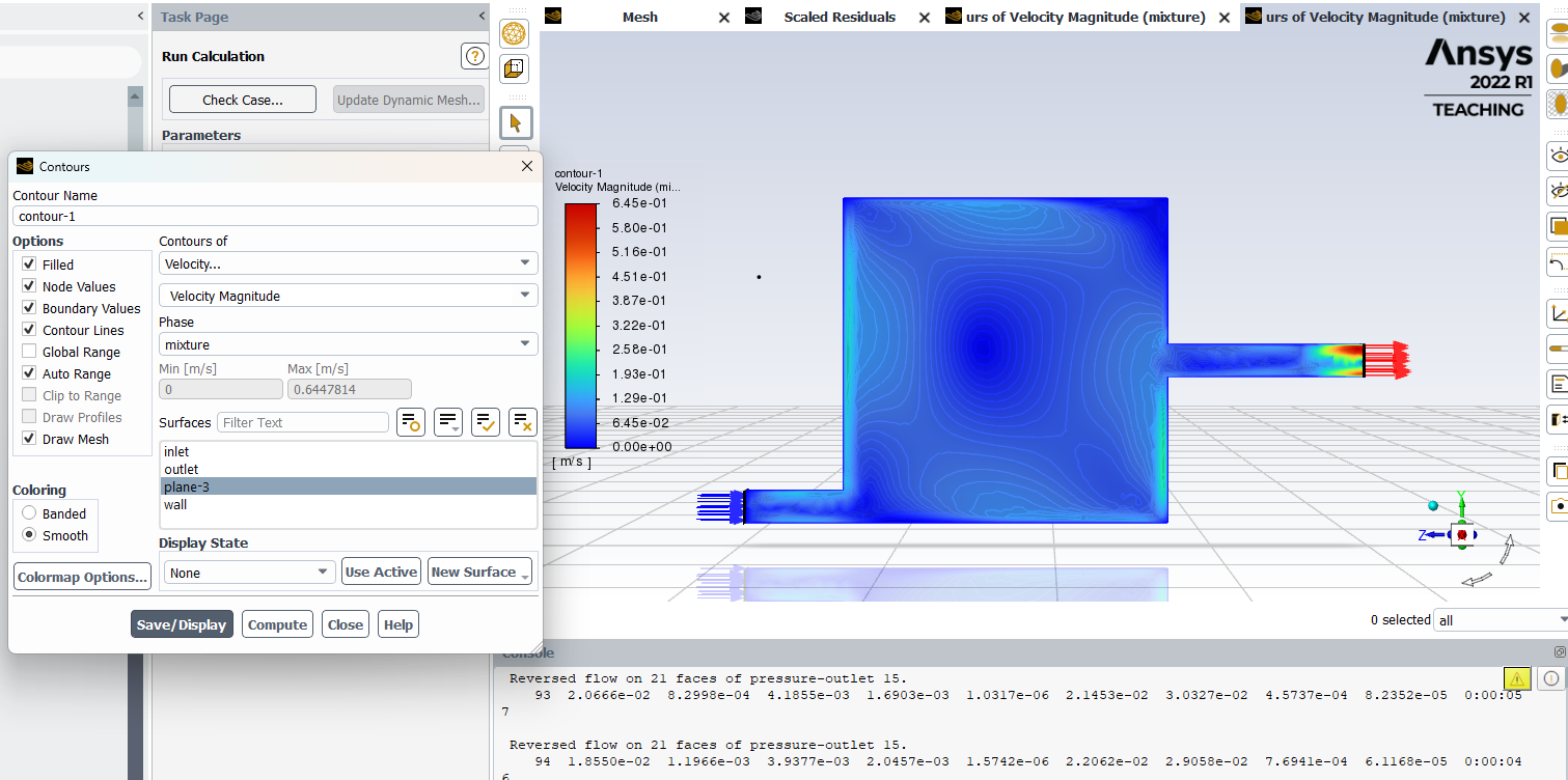

August 1, 2023 at 11:04 am
buksa
SubscriberI set volume fraction of h20 to 0.005, o2 to 0.228 and rest is n2. The densities of the substance are constant and the possibility of condensation has not been enabled.
- When i use same BC but operating density ,,minimum average phase" for expamle contour of velocity are as image 1 and residual image 2.
- But when i use ,,mixture average density" solutions are different (image 3, and 4)
- As you can see The results are so different that they destroy the whole simulation.
