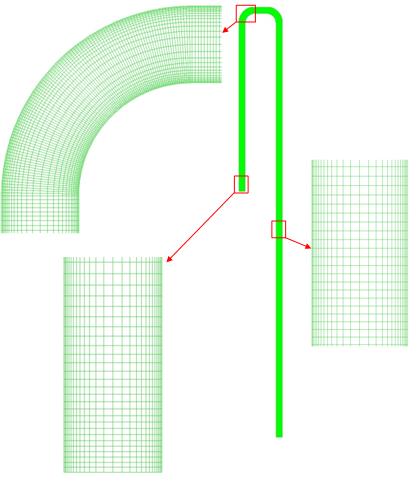

      I have a flow reversal in whole domain. In fact, I have put velocity inlet and if I monitor my vector plot at the inlet itself, they are reversed. It is a transient simulation that is initialized with a steady state case. The original steady state case has the correct direction of velocity vectors at inlet.
      Question: Why does Fluent overwrite my velocity inlet boundary condition and creates reverse flow!
    • DrAmine
      Screenshot of Mesh and Geo as well as boundary condition definition for inlet.
    • Raef.Kobeissi
      It must be something to do with your boundary conditions or your mesh. Can you please provide what Amine has requested.
      Thanks
    • TingWangUNO
      The geometry is a siphon as shown in the figure above. It has velocity inlet boundary condition on the left horizontal face...and a pressure outlet boundary condition on the right horizontal face. Gravity is turned on.
      For a steady-state case the results are perfect. However, I used the steady case results to initialize an unsteady case...this involves thermal phase change model as liquid water enters the siphon it flashes to produce vapor.
    • DrAmine
      Mesh is okay and at velocity boundary condition I won't expect reversal flow (not possible from the implementation side). Please provide a zero operating density under Operating conditions and provide the right gauge pressure at your outlet (as it opens to atmosphere I  guess ambient). Please add the plot of the velocity contours as well as the inlet boundary condition. Do not use the results of single phase flow as initialization for two-phase flow runs. I would rather start with two-phase flows, switch off VOF equation from the equations which will be solved and then switch back.

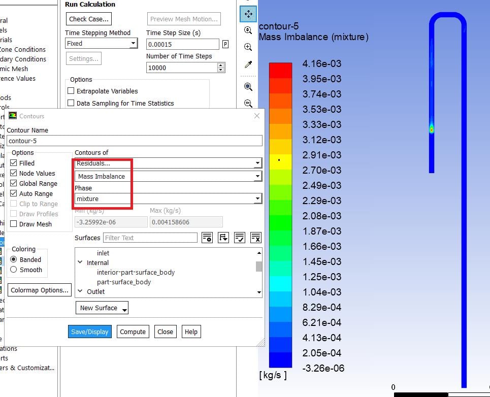

      I see that my simulation has a lot of mass imbalance...like if I plot mass flow rate difference between inlet and outlet...its huge.
      Question: In transient simulation should the mass flow difference between inlets and outlets be equal to zero? This is a phase change problem so it involves condensation and evaporation!! Would this be considered diverged solution then!!
    • DrAmine
      No as In transient you will have transient mass accumulation. But the mass out of one phase has to be the one into the other phase for phase change.
    • TingWangUNO
      So this is the Mass imbalance I plotted! It seems fine, right?
    • TingWangUNO
      I have adiabatic walls in this case, is there a way I could plot thermal energy imbalance as well?? Thank you.
    • DrAmine
      I don't know as it is just non scaled residual. Judge quality of results by monitoring temperature void and mass transfer rates so that the behavior remains  constant towards the end of the time step.
