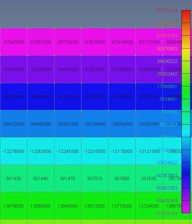

      I would like to know if there is any way to display the results for every node and/or element in ANSYS Workbench. I would like my model to see like the picture.

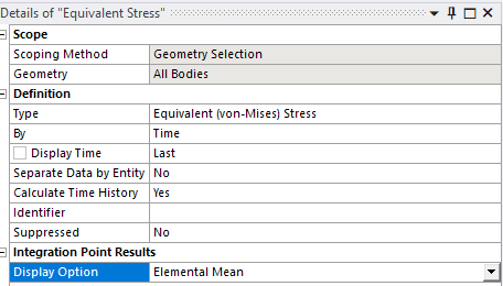

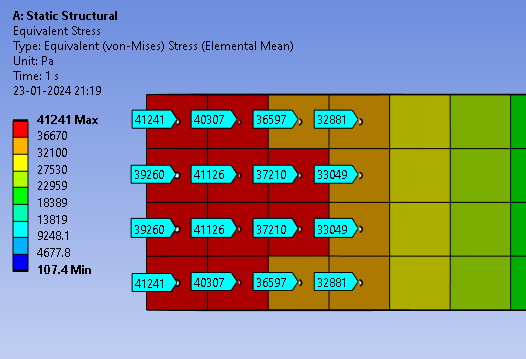

      Depending on what result you want to show, you can do this using the elemental mean display option:
      This won't directly give you the number, but you can easily use the probe feature to add the probes:
