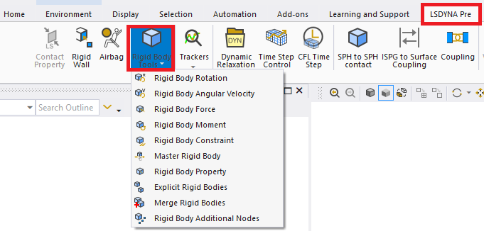

    • armin.abedini
      Hi Camilla,
      Could you explain how you defined velocity of the rigid plate?
      In Workbench LS-DYNA, it is suggested to use the options available under Rigid Body Tools tab in LS-DYNA Pre toolbar (see the picture below) to constrain motion of rigid bodies.

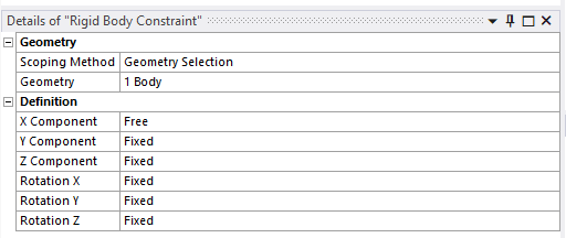

    • armin.abedini
      No problem Camilla.
      I would still suggest you use the Rigid Body Constraint from the "Rigid Body Tools" object to limit the motion of the rigid body.
      For example, if your rigid plate is expected to travel only in the x-direction, set all the other directions to fixed (see picture below, note that the X component is free), and check if you get the expected displacement value.

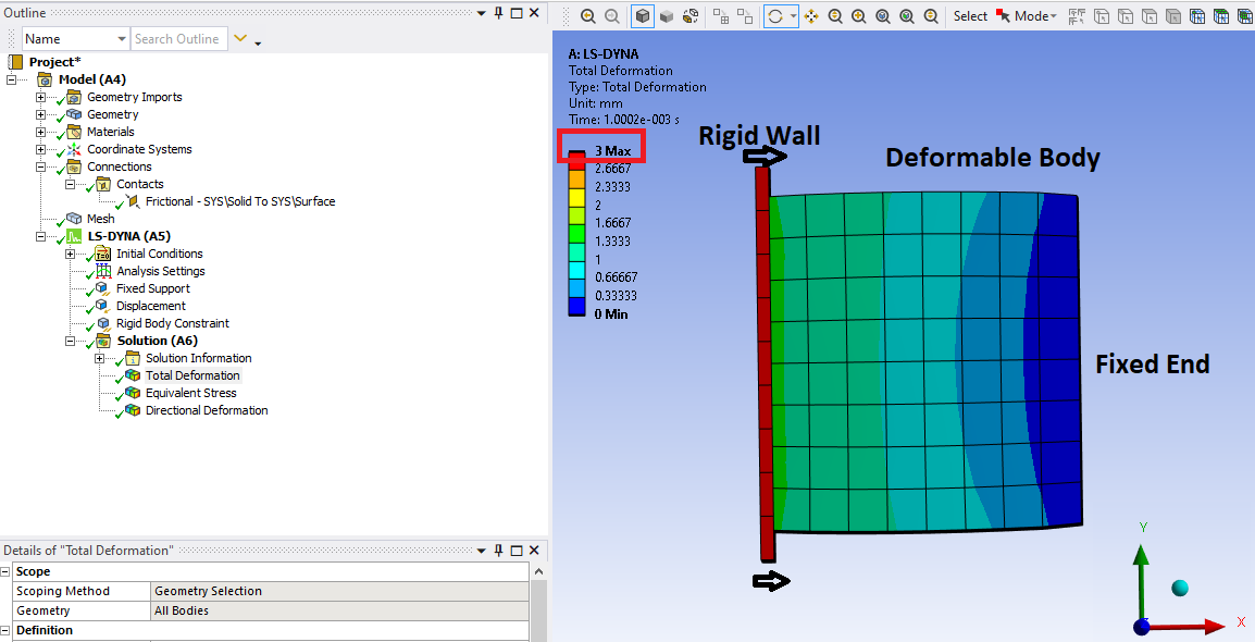

    • armin.abedini
      Hi Camilla,
      I just tried to replicate a similar case to yours by moving a rigid wall in x-direction by 3 mm to contact and deform a flexible block (fixed at one end). The behavior between the wall and block is frictional with coefficient of friction of 0.3. I see the expected deformation of 3 mm. I included a screenshot on my outline tree below for your reference and hoping it will be helpful for you.
