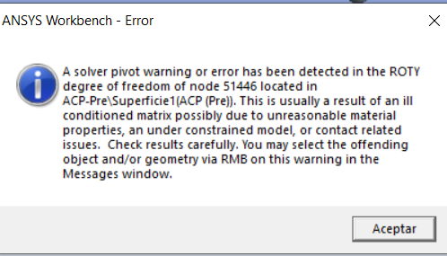

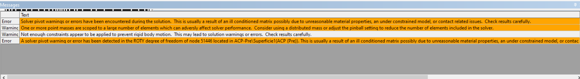

SubscriberHi everybody,nI'm simulating a kayak. I introduced the forces but I need at least one support.nnHow could I avoid this rigid solid motions so as I could simulate the kayak?.Thanks in advancen -

Ansys EmployeeHinOne way is to use inertia relief option in mechanical - under analysis settings.nthank younnErikn -

SubscriberI activated both Inertia relief and weak springs and it worked.nnThanks!!n
