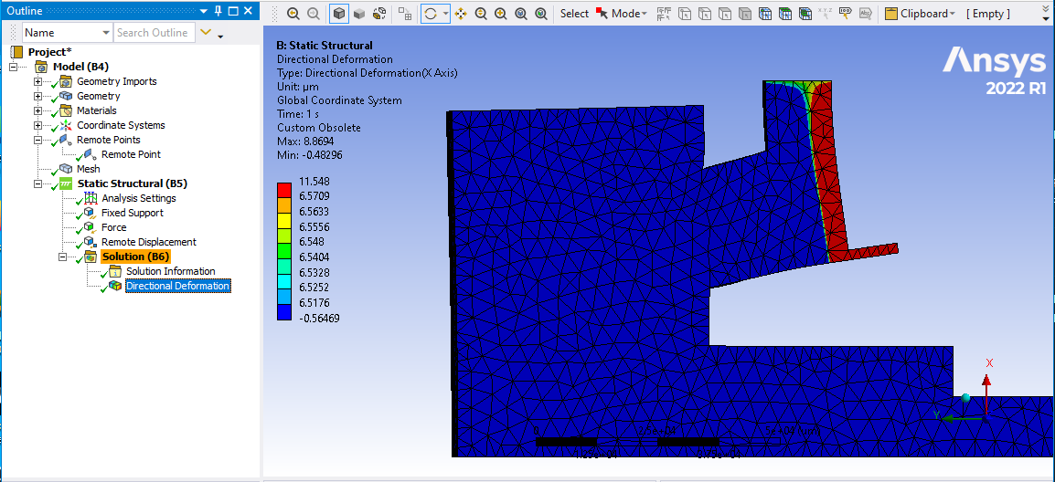

Below is a force applied to the top of the small area without a Remote Displacement.

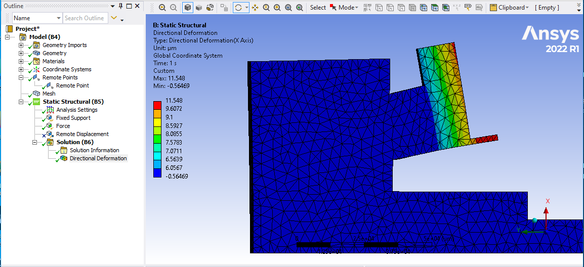

Below is the displacement with the Remote Displacement.
