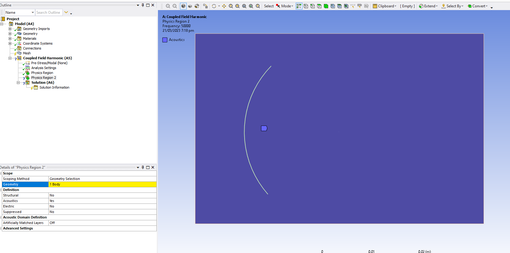

    • Hassan.liaquat
      Hi Eirk
      I did try coupled field harmonic. I have defined the structural region but cannot define the acoustic region. Please see the image below. The purple region is the fluid domain. I selected to define it as an acoustic region, but it's not accept it.
      It's a 2D model. Purple region is Fluid (water-liquid material), and this curved surface is a piezoelectric transducer immersed in the fluid.
      I am using a licensed academic version of Auckland Uni. of Technology.
    • Erik Kostson
      Hi
      Two things here to start.
      1. We can not have 2D geometry in harmonic acoustics or coupled field harmonic – so these systems are only for 3D analysis and thus need a 3D geometry.
      2. Set the material to water or air for acoustic domain and say steel (or material as needed) for structural under the geometry before defining the physics regions
      All the best
      Erik
