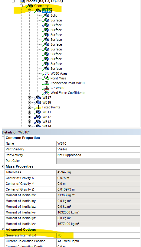

I wonder if you had applied the external lids for suppressing the natural frequency effect of the restricted fluid between structures (see 4.2.2. Suspending Standing Waves) and the internal lids for removing the irregular frequency effect (see 4.1.3. Removal of Irregular Frequencies) in the Hydrodynamic Diffraction analysis. If the distances of the surfaces of the structures between the structure-structure gaps are very small, please set such surfaces to be non-diffracting surface.

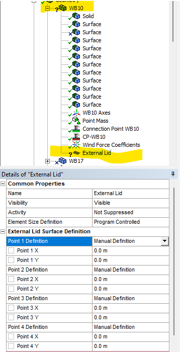

Ansys Employee(1) Internal lid can be automatically defined for each part by set "Generate Internal Lid" as Yes.
From Ansys version 2024 R1, you can directly define the external lid from Aqwa Editor associated to a part,

Ansys EmployeeA body is not non-diffracting, but it may consist of several external surfaces, you can just set the surface facing the gap to be non-diffracting.
In Geometry, you can define a surface on the mean water level, between the gap of the structutres and let its normal pointing upwards, and move this surface in the component of a structure.
In Aqwa Editor, you can set this surface as the external Lid.

SubscriberHi again, and thank you for your previous advice — it helped me resolve the convolution warning by defining the external lid as suggested.

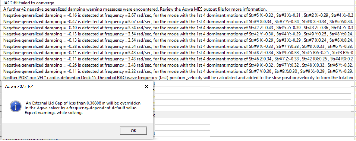

However, I’m still seeing the following issues:
JACOBI: Failed to Converge — This error still appears, and I’m not sure how to fix it. Do you have any guidance on what causes this convergence issue in AQWA and how I might resolve it?
Negative generalized damping warnings — The solver reports multiple negative damping values at specific frequencies like 3.54 rad/s or 3.67 rad/s, but these frequencies are not even part of the frequency range I defined in my diffraction analysis. Why is AQWA checking or reporting damping at these out-of-range frequencies?
External Lid Gap Warning — A message says:
“An External Lid Gap of less than 0.30808 m will be overridden... Expect warnings while solving.”
My gap is around 2 meters, so I’m confused about this message. Where exactly does AQWA measure this gap? And how can I avoid the warning if I already have sufficient spacing between structures?
