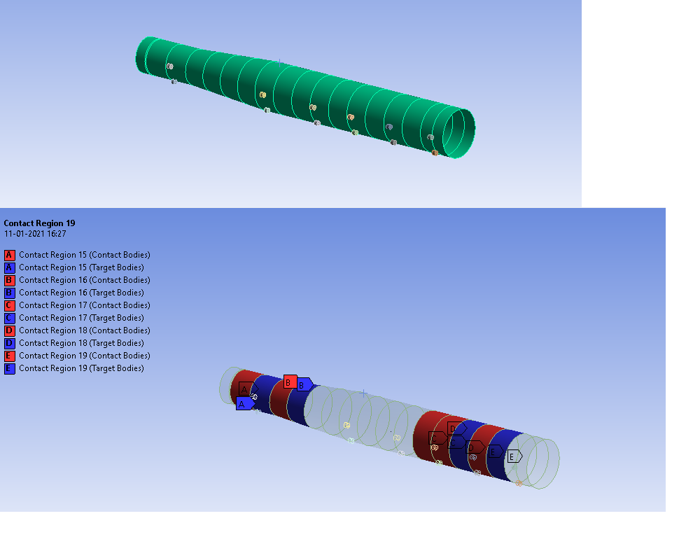

SubscriberI'm investigating the integrity of a MP under his self-weight. The contacts are all frictional between the rollers and the monopile. I've adjusted several things but it's never able to converge fully, only about half the weight is applied and it stops. Could anyone help me out?

SubscribernYou don't have duplicate surfaces, I accidentally did that when I was splitting the tubes, as I mentioned above.nDelete all the automatically created Contacts between the tube edges since you are using Mesh Merge (or Share button) to connect them.nThe frictional contacts all must have Adjust to Touch. I think this is why your model is not starting. I made a nice mesh on the rollers. I added very light spring to ground from the center of one end using a deformable connection to the edge, just in case the lack of an axial constraint was necessary. I could delete that and see if it was necessary.n

SubscriberThank you so much for your time and help, Peter!nAdjusted to touch accompanied with the light springs did the trick!nI'm in contact with my Technical Support now.nnP.S. The automatically created connections is because the tolerance value was that large (183mm). Reasoning that the model itself is large also.nnViewing 13 reply threads- The topic ‘Resolving convergence issues between shell bodies and solids’ is closed to new replies.
