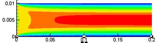

      That should follow the water pretty well. What does the velocity field look like?

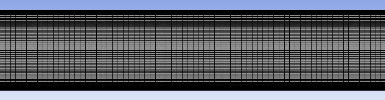

      Slip will occur as the particles try and separate: they're moving along the pipe with the liquid, but with gravity will try and settle.  What's the mesh resolution like?

      I am giving heat flux at the top and bottom boundary.

      Solution looks good with overpredict (11%). But my concern is it is not converging. I am validating one of the paper  where they have used all three model single phase, mixture and discrete model. Thats why i am also trying to do the same.
      Try transient. You'll probably finish up with a pseudo steady solution but that should assist with convergence. Also double check the paper settings to make sure you're modelling the same thing: there's often some ambiguity in there to hide something the author doesn't want to discuss.
