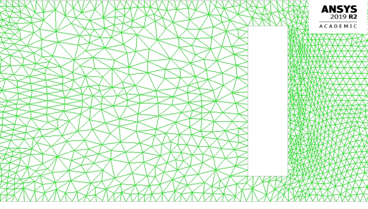

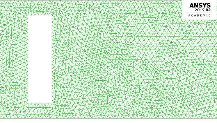

      Hello Guys, I have made a udf and previewed the mesh motion. But now I have to reset the mesh to the initial state in order to change and check few other parameters. Can you people tell me how to reset full mesh to initial state.
                                                            Initial Mesh Image
                                               Final Mesh Image

      No. There is no way. That is why we always recommend to save original case.
    • Ananth Narayan
      You mean, before previewing dynamic mesh, Whether  I need to save case file or data file or both. Thanks for the information.
    • DrAmine
      Before. It does not make sense after.
    • Ananth Narayan
      Thanks for your answer.
