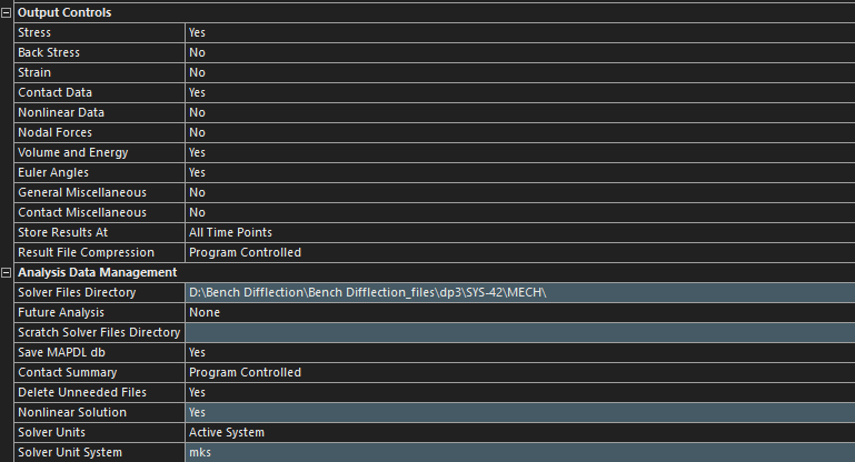

      Here are the simulation output controls:
      Thank you for any assistance you can provide.

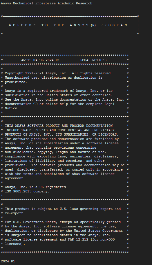

    • mrife
      Weird.  Please send a screen shot of the beginning of the solve.out showing the version and license used by MAPDL.
      Mike
      p.s. ndnext is just a short cut to *get command that would do the same function.  And works in any MAPDL processor...you're not using a custom version of MAPDL are you?
      • jmcclos8
        Hi Mike
        See attatched.
