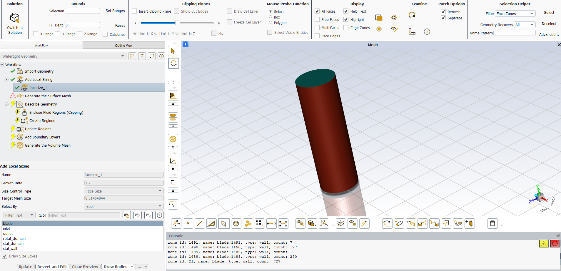

can someone help me with this problem
i do meshing with fluent mesher on Horizontal axe wind turbine with two cylindrical domain on rotational and other one is stationary
and i found this problem "Repair self-intersection using Share Topology was not sucessful. Carefully examine model in SCDM" when i generate the surface mesh
May 19, 2021 at 5:17 amKeyur Kanade
Ansys EmployeeThis means share topology operation in SpaceClaim is not successful.
Also it gives some intersecting faces/edges in Fluent Meshing.
You will need to share topology in SpaceClaim and use smaller sizing in Fluent Meshing.
