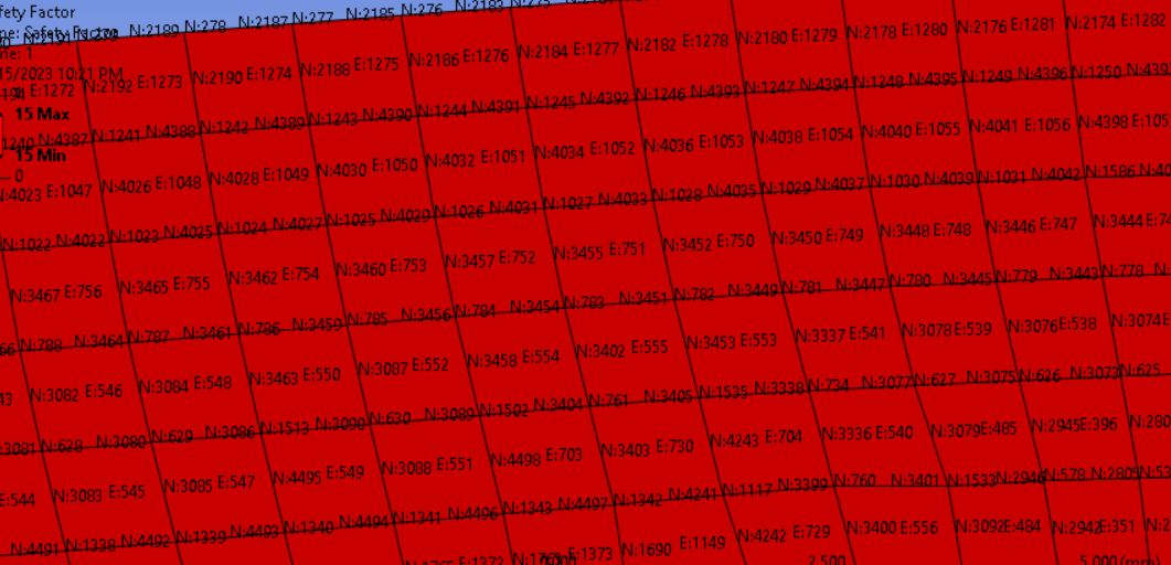

      Dear all,
      I am meshing a complex volume geometry and together with my inexperience I'm getting a mesh with elements with orthogonal quality lower than 0.05. As many of these elements are located at wall boundaries where I'm not interested to analyse the hydrodynamics, I was wondering if it is possible to remove those elements from the mesh.
      I know I can move the nodes but, is it possible to remove undesired elements from a mesh using Ansys Meshing?
      Attached is a figure of the mesh and the elements I want to remove (in red).
      Thank you.
      Kind regards,
      Eduardo

    • Eduardo Rodríguez
      How can I remove this labels?
      • Daniyal Ahmed
        Click on the Display tab and in the Annotation column go to 'Preferences'. At the bottom deselect 'Node Numbers'
