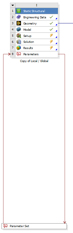

Is there any way to remove the whole parameter set from workbench? I wanted to do a mesh convergence study, but after having updated the geometry and modified the setup the parameters are just causing issues.
April 4, 2022 at 12:19 pmSahil Sura
The parameter set appears when we define a parameter by checking a box besides the respective property. A complete loop indicates there are both input and output parameters defined for the analysis system. It can be removed by simply unchecking the box next to the respective property and refreshing the project.
Hope that helps.

SubscriberThanks! I had unchecked all the parameters in Mechanical, but they still remained in the Parameter Set. The issue was resolved by closing and reopening workbench, and then going through and unchecking the parameters again.
April 4, 2022 at 1:19 pmjonsoln
SubscriberActually, on further inspection I see that all my work since the problems with the parameters started has now been undone, even though I saved the workbench project several times. This is a serious bug in Mechanical / Workbench, costing me many hours of work... Is there any place I can report this bug with more details?

SubscriberI'm using ANSYS Workbench 2021 R2, not academic. The problems started when submitting the design study to a remote solver queue. This gave a lot of warnings that the solver license was not available, though the simulations eventually solved. Trying to change parameters and other things in the setup in Mechanical afterwards gave errors saying that I couldn't make changes while a design point was active, though all design points were solved and no jobs were in the RSM queue.
