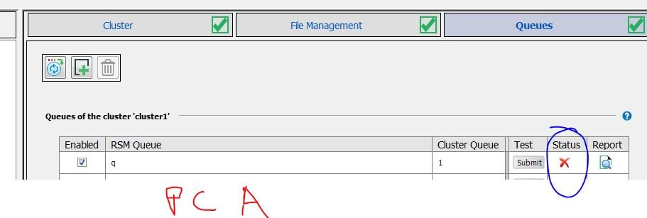

      Hi there
      I have 2 pcs in the laboratory  (university) pc A and pc B with win7  {ANSYS ACADEMIC}.
      On A I have installed all tools (incl Workbench) of ANSYS and I am willing to perform some FLUENT analyses .

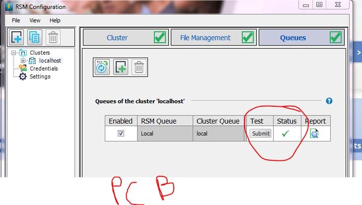

      On B I have installed just the stand allone RSM (remote Solve manager) willing this pc to be my COMPUTE server.
      After resolving some issues about configuration  of rsm on B and how to input the RSM staging directory path on both A and B, I have finally achivied on submiting TEST job with B (Actually sending a test job to itself, as it is the compute cluster server) which has Status : SUCCESFUL
      In the same time from pc A, the TEST submissions haults with error : CLUSTER doesn't have queue "Queue name"
      last lines of the FAILED report are :
      Running 4 commands
      Job will run locally on each node in: \09CD-PCRMSstagingqr5eobpz.fll
      Number of CPU requested: 1
      AWP_ROOT180=C:Program FilesANSYS Incv180
      Testing writability of working directory...
      If you can read this, file was written successfully to working directory
      Writability test complete
      Checking queue 1 exists ...
      Cluster does not have queue 1
      Submit Failed
      Failed to find cluster queue 1
      Any ideas about how to resolve this?

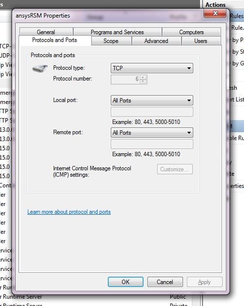

      Did you open port 9180?  Does PC B have multiple network cards?
      Thank you,
      Jake
    • gdimadis
      actually all ports are open for ansys rsm (if i did it correctly..)

      As for the firewall, which .exe files are you allowing?  Ideally you would allow all .exe files in the RSMbin directory.
      Also are there multiple network adapters on PC A and PC B?
