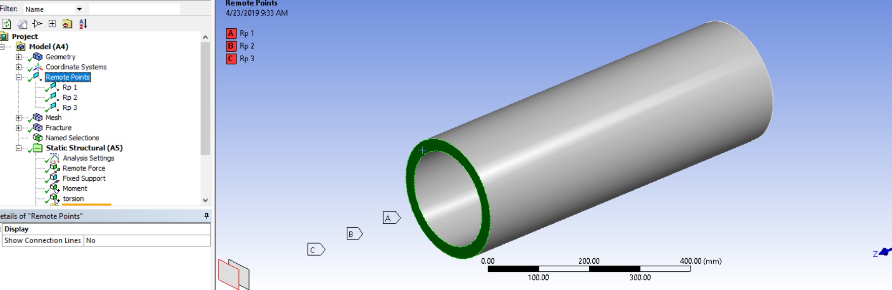

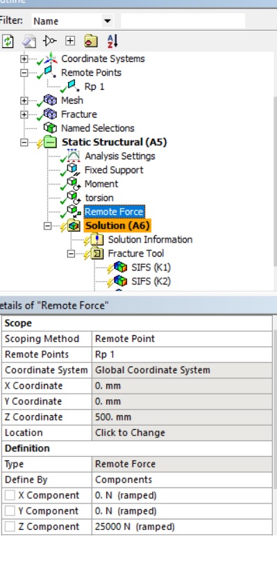

I want to ask about remote point in workbench, cause I'm receiving some errors which I will show you here, actually what I'm trying to do is applying three types of loading on one end of a cylinder while the other end is fixed.Â

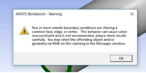

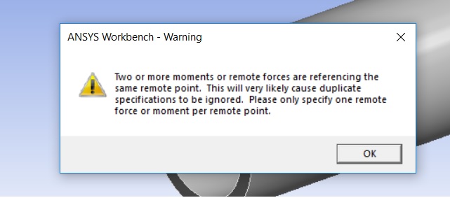

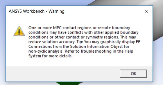

I used remote point, cause the all researches in this area use it, so, I have to apply tension, bending and torsion to the same cylinder end. I tried to use single remote point and I linked the all three types of loading and I received a message that using more than type of loading could cause ignoring to one of them ( the loading types). Then, I created three different remote points but the all three connected to the same cylinder end, and run the analysis and I got two messages showing below :
finally here is the cylinder and the three remote points, the green end where I linked the three remote points, while the other end is fixed.Â
Could you please suggest me a solution for this case , and thanks to all in advanceÂ

peteroznewman

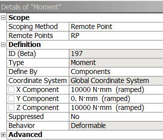

SubscriberIt's best to apply tension, bending and torsion all to a single remote point. The single remote point is the only object scoped to that one face. Use a Remote Force to apply the Tension and select the Remote Point you created. Apply a Moment, select the Remote Point and Define By Components to apply the Torsion and Bending moments in the correct component rows.
You will not get any warning message in this way.
You wouldn't get any warning messages if you just applied the force and moment to the face directly and used no remote point.

SubscriberThank peteroznewman for your answer,Â

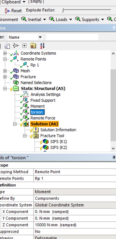

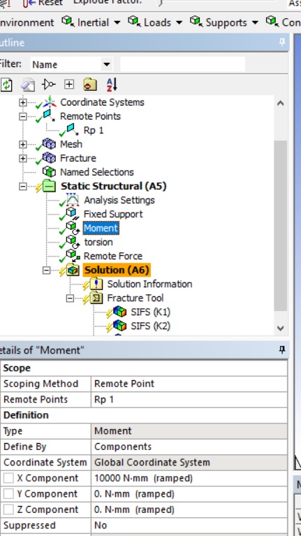

actually I tried to attach all the three types of loading to the single point of loading, but I got this message:
this is the details of each one :
I tried also to apply the all loading types without remote point but the error messages still same !
I think I misunderstand you, could you please explain it to me if I'm wrong .. thanks againÂ

ammorey
Subscriberthank you so much, I did not receive any warning ..Â
I'm using 19.0 version ,Â
thanks again for your help Â
