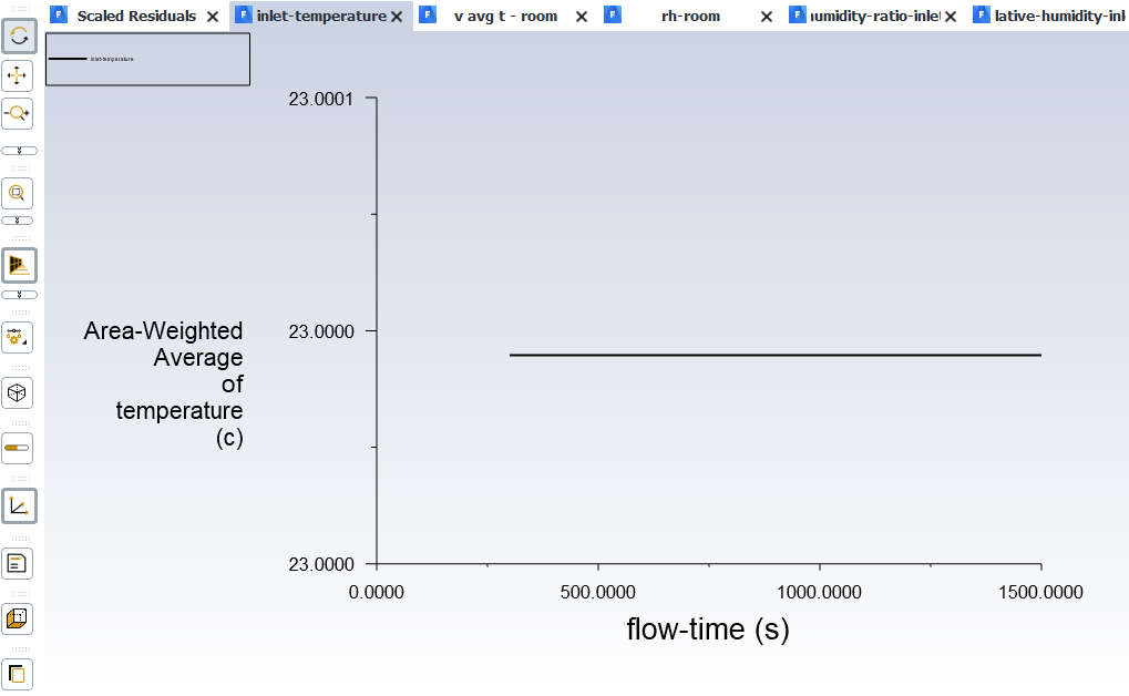

I am trying to simulate a humid air that enters a room through an inlet, with transient simulation.
I have activated species transport with air and h2o mixture.
At the inlet boundary condition, I specified the temperature as constant (at 23 C) and the h2o in species (I understand that this should be the humidity ratio value) as constant at 0.0106. And these values are working fine as you can see in these two pictures (I read these values at the inlet with average-weighted-area)

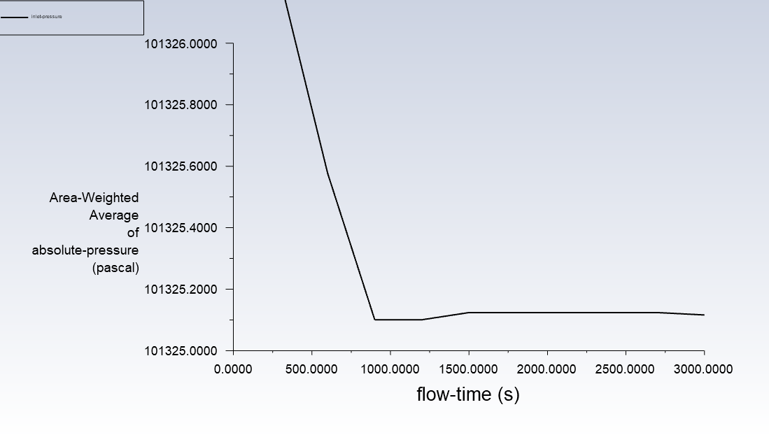

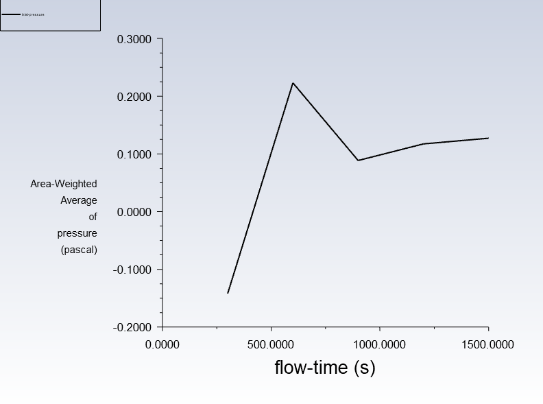

SubscriberHello drAmine, seems like I've found a strange problem.
This is the area ave of pressure at the inlet.
I stopped the simulation at that time, since I know the pressure should be constant (with constant velocity inlet), am I correct?

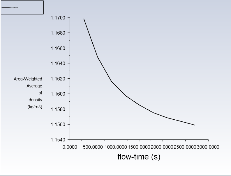

Also, the ave area of inlet density looks like this. It should be constant, right?
(EDIT: I have just found out that the static pressure read in the plot is actually gage pressure).
And I have noticed, that the trendline of the RH is very similar to the trendline of density. So I'm thinking that the density is may be the one that causes the problem?

December 10, 2021 at 12:08 pmDrAmine
Ansys EmployeeOkay so the RH reported by Fluent will depend on that value of pressure and temperature. For that reason I recommend writing a couple of expressions which will translate your RH input into mass fraction given the absolute pressure at the inlet.
