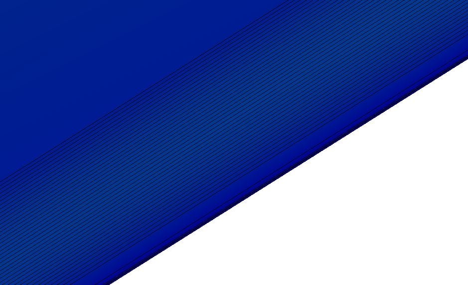

I am trying to mesh a delta wing in ansys mesher. I have created a body of influence around the body and used the following paramaters
General Mesh settings:
Fluent Mesh
Capture Curvature No
Capture Proximity No
Mesh Defeaturing No
Max Angle 180deg
max height over base 0.7
body of influence:
element size: 5e-3m
face sizing (on the wing):
element size: 1e-3m
capture curvature no
capture proximity no
Inflation (on the wing):
1st layer height: 1e-6m
Number of layers: 45
growth ratio: 1.17
With these parameters I get a mesh without any warnings. However, it results in a rather large mesh. In order to bring the element number down I would like to increase my element size in the body off influence. When changing it to 8e-3 I suddenly get stair stepping. I was wondering why I get stair stepping when changing the body of influence element size and what can I do to avoid stair stepping? Is there a way for me to know how face sizing, inflation layer and body of influence sizing have to relate to each other?Â
The trouble is that I need a lot of elements on the wing surface so increasing the face sizing on the wing is not an option. I can increase or decrease the 1st layer height but will need to change the number of layers accordingly. -

Ansys Employeecan you please insert image of your geometry and boi.Â
is your boi covering entire wing body?
in face sizing, can you please use 'hard' behaviour.Â

SubscriberSure, find below different views of the boi with the geometry. I use a half model and apply symmetry boundary condition in case this isn't clear from the image. I figured that when I change the growth rate to 1.2 I get it meshed but I'm still unclear as to what the relation is. I will try one with "hard" behaviour and my previous settings which resulted in the warning too.
Btw is there any recommendation for the "maximum height over base" setting?
And thank you for the quick reply on this post!

SubscriberWhat you see is the BoI. The domain is 20 chord lengths. I couldn't depict it otherwise you would not have seen the geometry. The domain is one body. The body of influence are two bodies as depicted in the picture. Shall I merge them into one?Â
I also get a funny inflation layer. After around 20 layers or so it stops growing but adds smaller layers (see picture). Thus, I'm not capturing the boundary layer. Is there anything I can do to avoid this? I have tried using total thickness but getting a collision warning and the mesher stops without creating any inflation layer

SubscriberI have tried to use a boi as a single domain without success. I decided to use a geometric type of inflation which gives me better inflation layers but stair stepping which is so severe that the layers around the tip totally collapse -

Ansys Employeeplease use single boi.Â
also i can not understand anything in the latest image you have posted.Â
