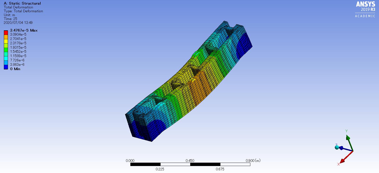

      the reinforcement in my model refuses to solve and I do not know why
      I am a beginner on ansys and I do not know if I am doing the right thing
      This is a reinforced 3D printed concrete beam I modeled and imported into ansys workbench
      3D printed reinforced beam
      the reinforcement bars are embedded between the layers. all bodies are labeled so i assigned the concrete and structural steel materials accordingly
      i treated it as a simply supported beam,
      only the hex dominant mesh worked for this model and it got solved but the rebars did not deform. I do not know how to use codes or APDL, but i copied the prep 7 code to try to bond the concrete to the steel but the solution output got stuck midway without progress for a long time
      this is the material parameters I set for concrete (its a cementitious mortar actully) and I am using the default structural steel for the rebars
      please help, it`s an emergency

    • Bukky1
      thank you very much for your response.
      I do not know any codes, I am a beginner, however I found a solution thankfully.
      I selected the affected contact bodies and changed the formulation setting to `Beam`
      This was such a relief!
