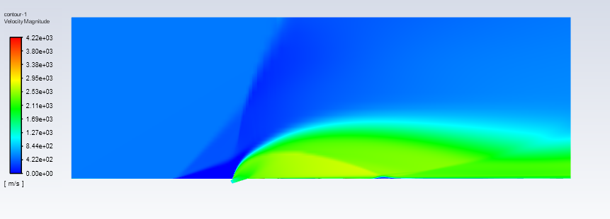

      This is the steady state solution velocity magnitude curve of nozzle flow interacting with crossflow of Mach 2.
      I am assuming roughly 2000 m/s to be mean velocity of nozzle, and the length of right part of domain is around 5080e-3 m.
      Does that mean approximately ( 5080e-3 /2000) = 0.0025400 seconds the flow will take to pass the domain.
      And for given time step size of 1e-8 calculated based on CFL < 1 and smallest grid size, I should give total number of time steps as (0.0025400/1e-8) = 254000
      So, after 254000 one flow passage will occur and for accuracy of the solution we wait for 3-4 flow passage, which means I have to wait for 3*254000 = 762000 time steps in total to do further post processing.

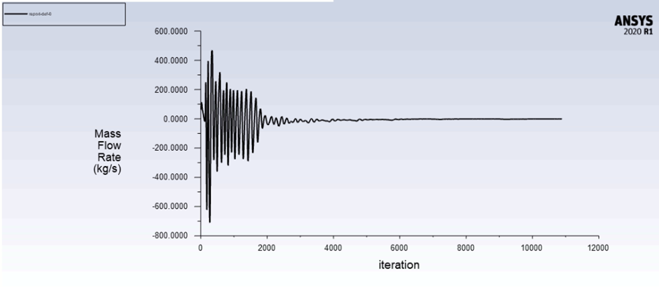

      Sir, the reason for doing unsteady simulation is I am not getting my mass imbalance perfectly constant it keeps on fluctuating even though the mass imbalance is of order 1e-4 but still it never remain constant e.g. 0.000145 : next iter 0.000124 : next iter 0.000154 an so on. It is not remaining constant like 0.000145 : next iter 0.000145 : next iter 0.000145.
      Above is the plot of mass imbalance for steady simulation it looks like constant but actually it isn't.

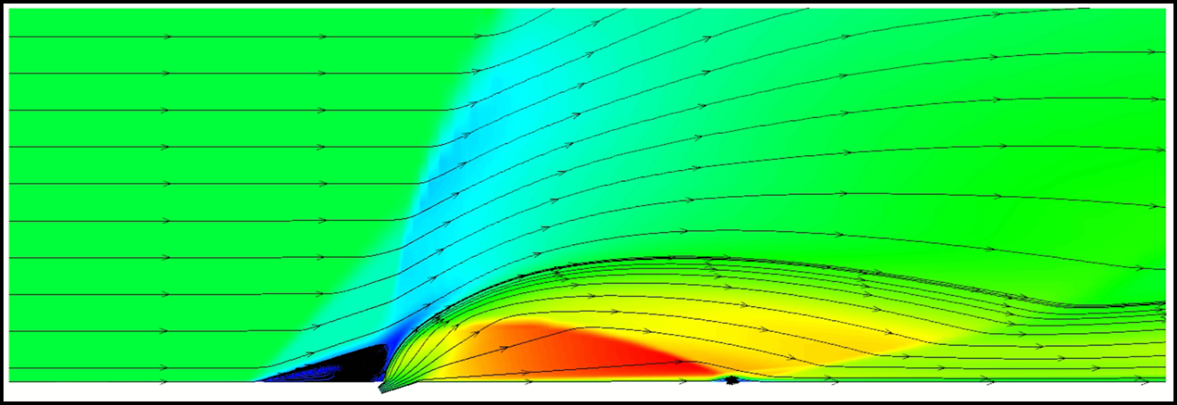

      If you look at below Mach contour of steady state solution, there are recirculation regions present, because of it, I think circulation region is slightly changing in size, which might be the reason I am not getting constant mass imbalance.
      Thus for that reason only I am think I should do a transient simulation as well.
      Is this reason good enough to do unsteady simulation ?

      How constant do you expect the result to be? Around 0.1 in 30463.8 looks pretty constant to me. Similarly, we're after a mass balance within about 0.5% of the minimum flow boundary. If you monitored the experiment to that level of precision what kind of sensors would you be using?
