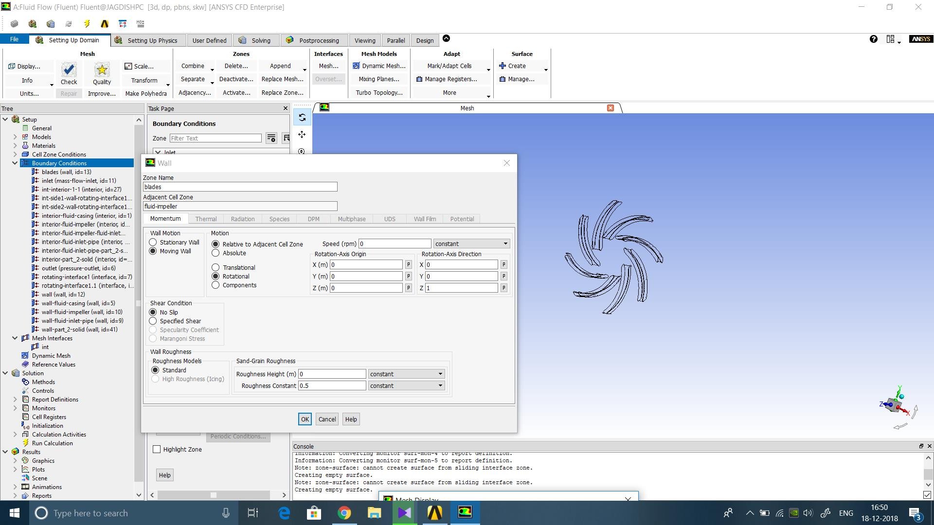

    • Adidash97
      This is the blade wall condition which is rotating
      This is the inlet pipe which is stationary and not rotating
      This is the impeller wall which is rotating w.r.t to the adjacent cell zone
    • Adidash97
      So as per the solution given by abenhadj that the stationary wall setting is relative to the adjacent cell zone, the impeller wall which is rotating can be assigned as a stationary wall. Then also I still receive the message I had posted earlier "Review wall motion. Stationary wall motion adjacent to cell zone detected". What is wrong with the boundary conditions?

      But why am I receiving that message? What is the correct way of providing a stationary boundary condition? Is it "stationary wall" or "Moving wall with zero velocity"? I am really confused with these two?
    • Amine Ben Hadj Ali
      If the wall is not moving in absolute system then set it as moving in absolute system and give zero angular velocity.
      Stationary wall settings is always relative to the adjacent cell zone. Setting the wall to Moving and using zero RPM you will need to set whether it relative to absolute system or just relative to the adjacent cell zone. If the adjacent cell is rotating and you set Stationary wall then the wall will be rotating relative to the absolute system. If you want the same but using "Moving Wall" option then use "Relative to Adjacent Cell zone" and give 0 RPM.
    • Adidash97
      I did the same but getting the message.
      Then ignore the warning message already mentioned here at first and check results afterwards. Check what has been suggested thoroughly. Default behaviour is stationary relative to a adjacent cell zone. Walls of rotating impeller can be then set stationary relative to impeller zone or rotating with zero rpm relative to the same zone.
      Global stationary wall which does not rotate better made through zero rpm relative to absolute frame.
