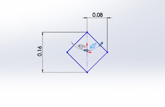

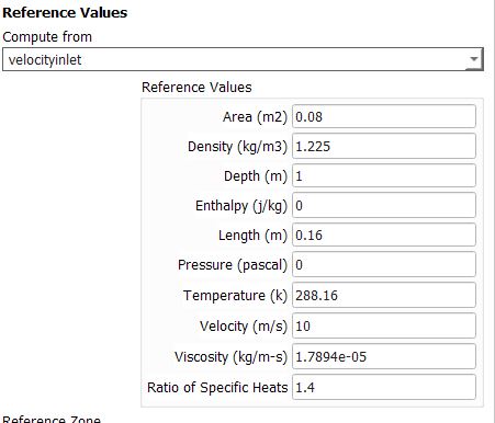

      I am unable to obtain good solution in Fluent due to reference values . Not sure about how to calculate for the following geometry.

      The result is correct: report the forces.  Lift & drag and pressure coefficients are dependent on the reference values so need to be calculated for the model.

      I am getting drag as 10 newtons and Drag coefficient as 1.55. But for 3D model drag is only 1.98 newtons . Please let me know what values to be taken.
      2d assumes the domain is 1m thick; 3d and you have a defined thickness. If you account for the 2d "thickness" how does it compare?
