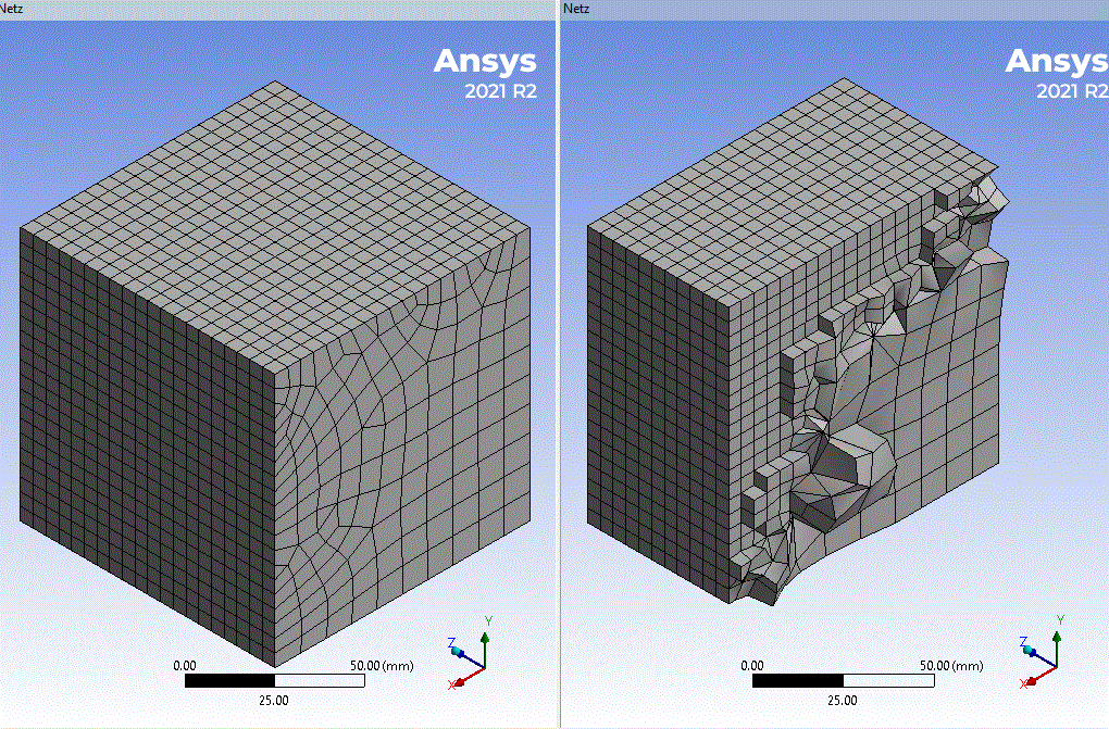

      Hi guys I am looking a feature to increase the mesh size towards inside of the solid ( I know Patran had) also increasing the element size towards to edge that I can reduce the model by increasing element size for the not interested areas.

      Perhaps other more experienced users can suggest better ideas.  I could imagine achieving this by specifying an element size for the overall body, and a smaller size for the surfaces (possibly all of them) where I want a more refined mesh.  This is a trivial example where I specified a size equal to half in the two surfaces on the left and top.
      For the second part of the question, the Bias Type and Bias Option should be what you are looking for.  They work only if you select a line, of course.

      Assuming that you are using  workbench mechanical, please take a look at:
      https://ansyshelp.ansys.com/account/Secured?returnurl=/Views/Secured/corp/v231/en/wb_msh/msh_glo_and_loc.html
      Please note you can not increase a mesh size larger than global size (https://ansyshelp.ansys.com/account/Secured?returnurl=/Views/Secured/corp/v231/en/wb_msh/ds_Sizing_Group.html). You will have to use largest required global mesh size first and then use local sizes (https://ansyshelp.ansys.com/account/Secured?returnurl=/Views/Secured/corp/v231/en/wb_msh/ds_Meshing_Sizing.html) to refine the mesh as required.
