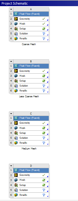

      I had to close down my Ansys FLUENT session as the program crashed when attempting to produce charts. Even though I saved the project prior to running the calculation, when trying to recover the project only one geometry remained and all Mesh and calculation setup data has been removed from the session.
      Files are still present within the dp0 file, and I was able to import geometries back to the workbench:

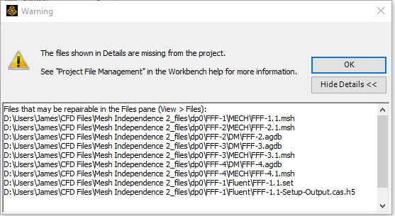

      A follow-up issue now is the following error message:
      Checking the directory of the project that crashed, indeed FFF-1.1.msh is not there, FFF-1.msh is there. So for some reason when opening the crashed project, the directory is searching for mesh file 1.1 instead of 1. This is the same for FFF-2.msh, FFF-3.msh and FFF-4.msh; for some reason reopening has added a ".1" to the file name in the directory the program is accessing. FFF-2.agdb, FFF-3.agdb, and FFF-4.agdb are all missing but can be updated as FFF-1.agdb is available and the geometry is the same for each run.
      How do I prevent Ansys from looking for the wrong file in the directory? I didn't modify the project in any way, I just reopened the .wbpj file and the search directory is different to the original directory.
    • RK
      In Workbench, go to Tools --> Options and check the directory entered there. Also, when you click on each project cell, to the right of your screen, you can see the directory. Make sure the directory it is pointing to is right.
