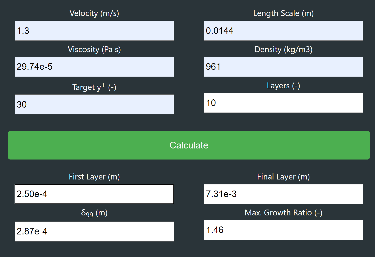

recommended values for transition ratio/last ratio
    • vitus
      im using the option last ratio to generate boundary layers in Fluent Mesh. So I can choose first cell hight, number of layers and last ratio. But Im not sure what to use here, to get a smooth transition and as many layers as possible. My cell size is about 1mm, but if I take 10 layers my final layer should be 7.31 mm, so this wont really fit.
    • RK
      I would recommend using a first height for the prism layer for these values and then adding 10 layers with default transition ratio. This recommendation is without actually looking at the mesh and the model. So, you can generate the mesh with this settings and check if the BL is good enough to capture the physics or check y+
    • vitus
      default is at 0.272... i thought something near 1 should be a smooth transition?
