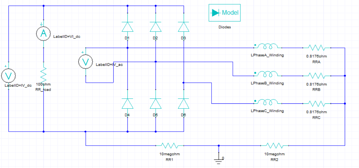

SubscriberI constructed a 3 phase winding circuit using Ansys Maxwell Circuit Editor and assigned winding excitation to this external circuit. I want to get the readings of dc output voltage and current using voltmeter and ammeter parameters (V_dc and I_dc). I tried to add this parameters to project but they are imported to Maxwell 3D with 0 value that doesn't change.
How I can read these parameters or where I can find them?

If I understand correctly you want to plot the readings of Voltmeter and Ammeter.
Once you imported the circuit netlist for the external circuit, they will be automatically available for you to plot in the rectangular plots.
For example, I have added an additional voltmeter as shown below.
When I got to Results>Create transient report>Rectangular plot I can see the voltmeter under node voltages to plot
Look under node voltage and Branch current under Category.
