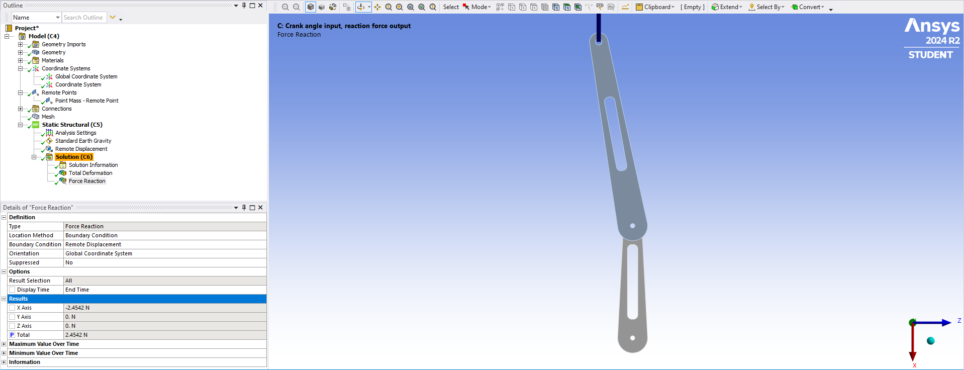

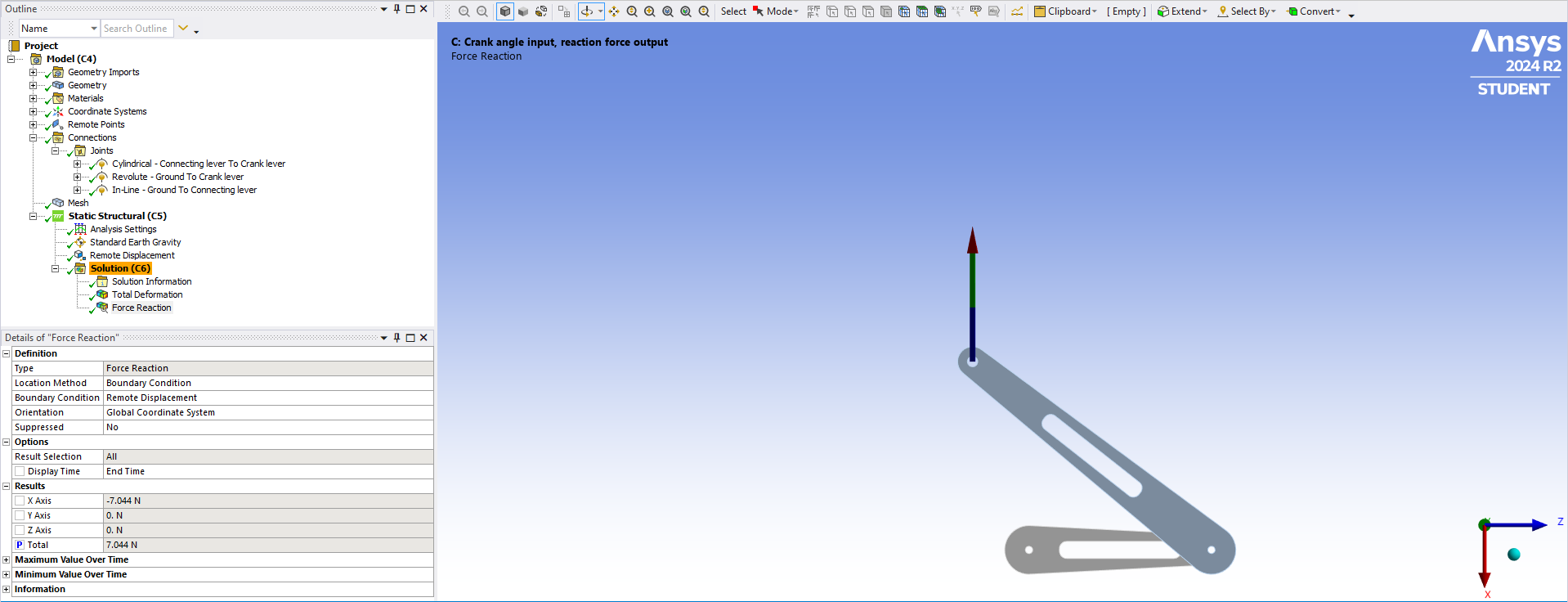

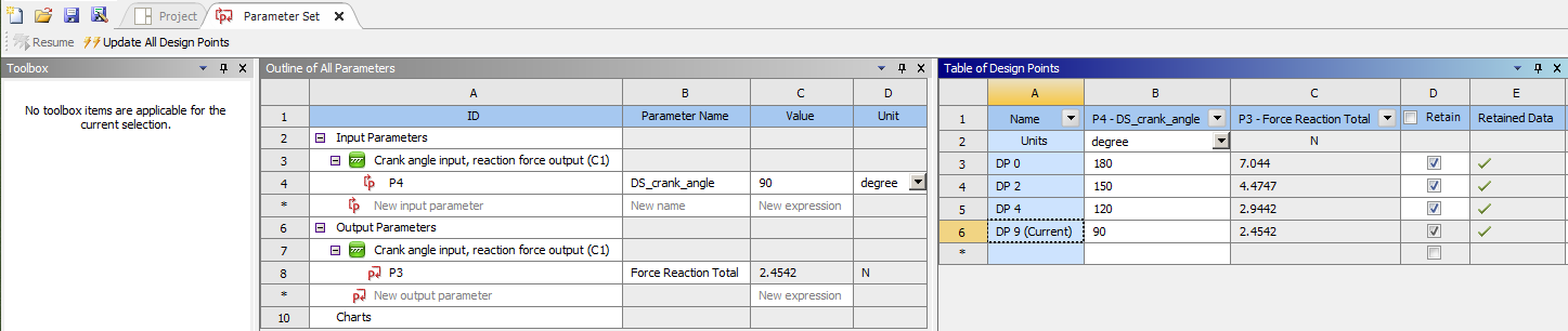

      Use SpaceClaim Assembly constraints to define the mechanism and create an input parameter to pose the mechanism at different angles of the lever. Use Static Structural to solve for the reaction force to support the pivot at the top of the lifing link in that pose and make the force an output parameter. Finally, use the Workbench Parameter Set: Table of Design Points, to step through a set of input angles and compute the reaction force to draw a graph from the data in the table. One click on Update All Design Points will automatically fill out the table.

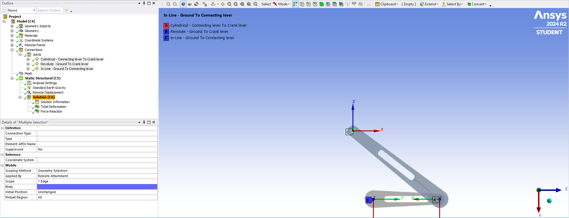

      This example has two links with the following three joints. The In-Line joint allows the top pivot to slide along the local Z direction and leaves the rotations free.
      A remote displacement has global X (local Z) set to 0 at the top pivot and the reaction force is output.
      Here is the Table of Design Points with the input angles to pose the mechanism and the output Reaction Forces.
      Here is the final angle in the table.
