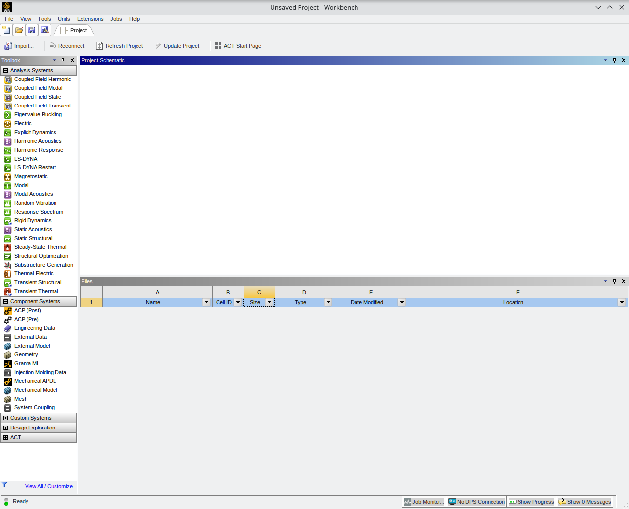

    • sa-aadat.parker
      Hello Ram, Thanks for the response but I can't find the "Write Input file" menu option. Screenshot

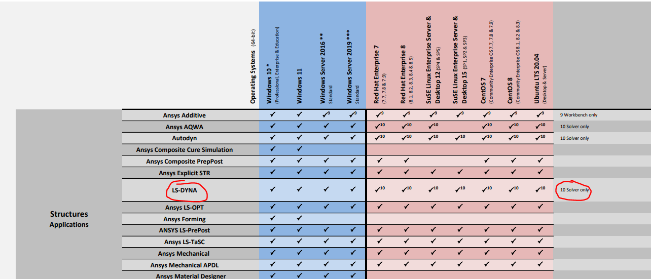

      I don't think we can import a .k file in WB 2022R2 on Linux. This can be done on Windows (see below). Note that only the LS-DYNA solver is officially supported at 2022R2 and not the user interface on Linux:
      https://www.ansys.com/content/dam/it-solutions/platform-support/ansys-2022r2-platform-support-by-application-product.pdf

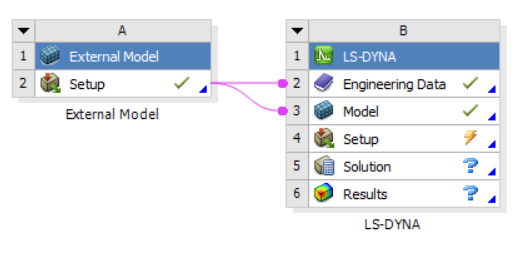

      If you want to import the .k file in WB, you will have to find a Windows machine, install WB 2022R2 and import the .k file using an External Model system as follows:
