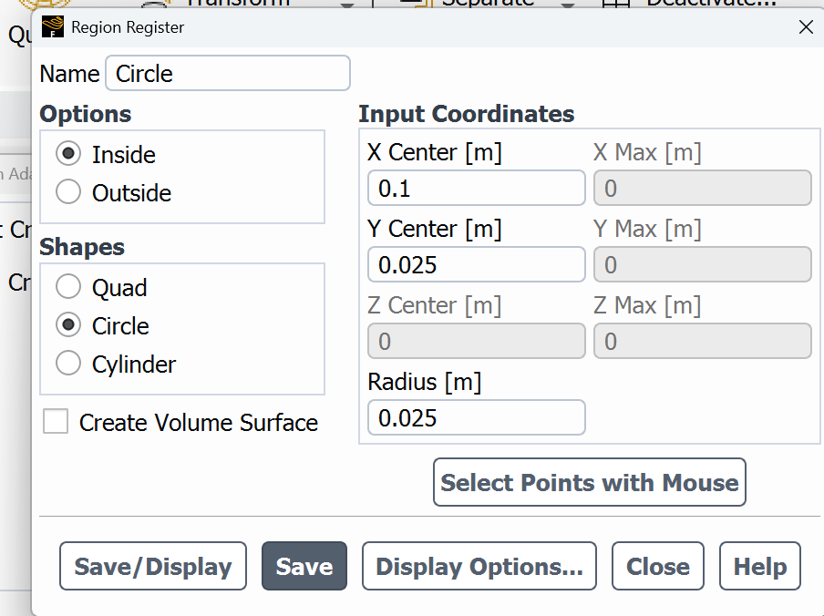

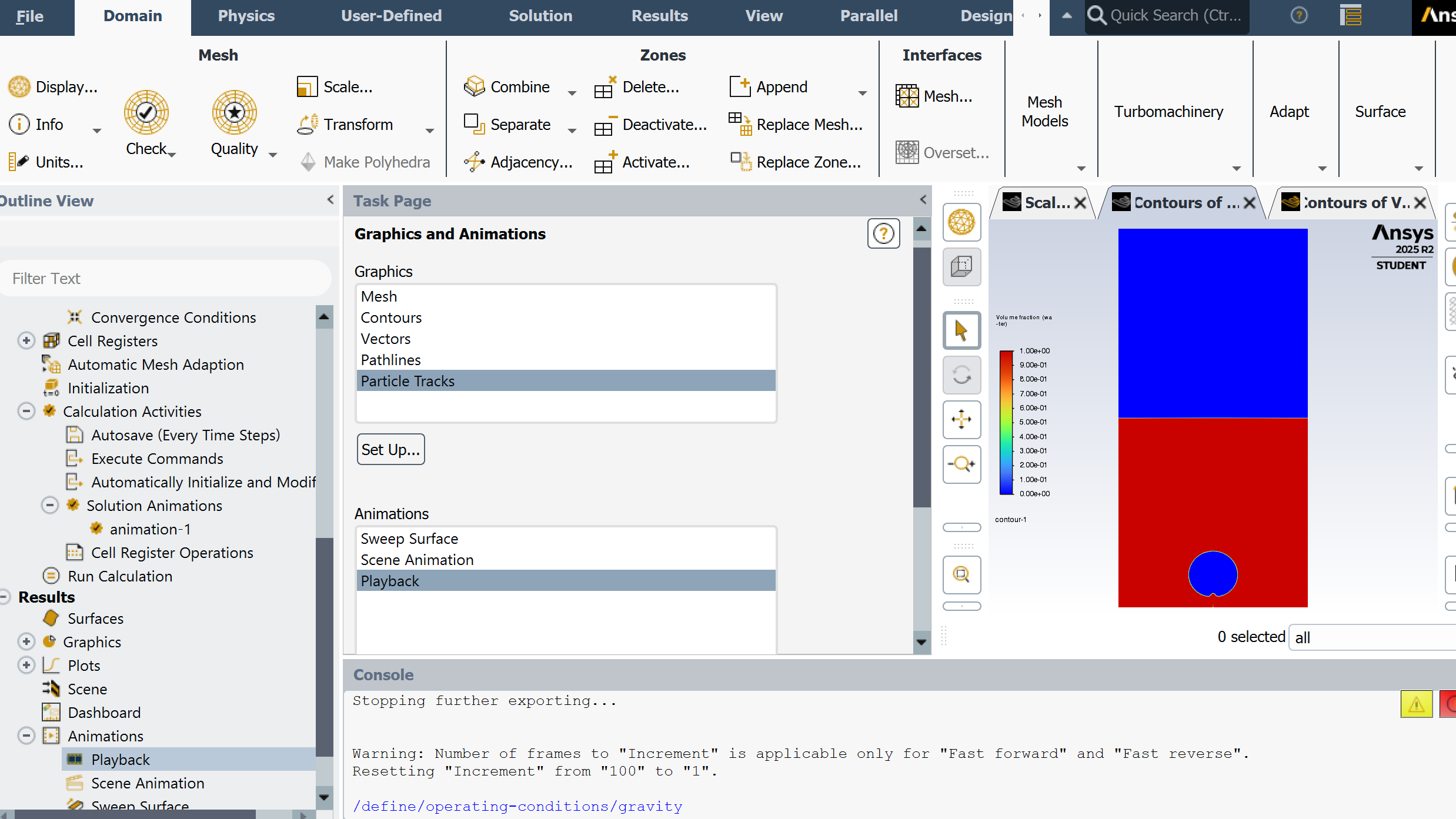

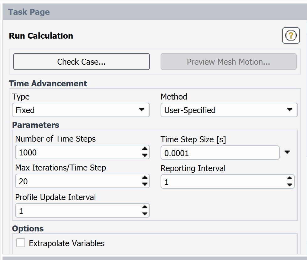

SubscriberCan somedody show me steps to do the setup of raising bubbles? My simulations only the bubble is raising a few distance and that it.

Rob
Forum ModeratorAssuming gravity is on, and the bubbles are large enough to not be carried by the flow most bubbles will go up. Maybe try adding some detail to your question?Â

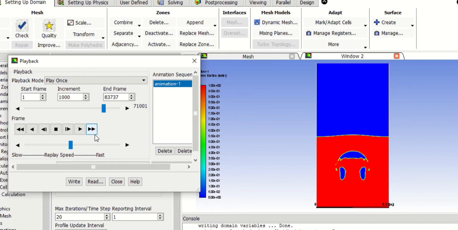

mcalderonleon
SubscriberThe bubble must to be raise, and get the form of the last picture.

mcalderonleon
SubscriberThe problem is that the bubble do not raise at all.Â
April 14, 2026 at 8:27 am

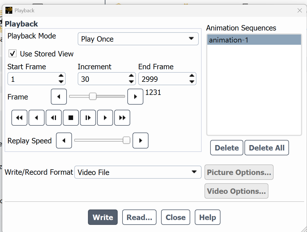

Rob
Forum ModeratorWhich comes back to gravity, assuming you set each phase as a different material? However, looking at your first image and the last the bubble has risen, formed a cap and begun to break up.Â
