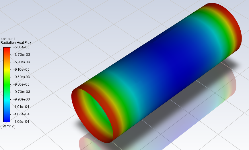

· In the second case, I solved only DO equation (turned off the flow and energy equations under Solution -> Control -> Equations), since I wanted to calculate the radiative heat flux when the temperature inside the cavity is 1200K and wall temperature is 300K. DO method converged in a few iterations. However, the radiative heat flux at the wall is showing as zero. I guess, this is because the energy equation is not solved. Is there any way I can calculate the radiative heat flux, after DO method converges?

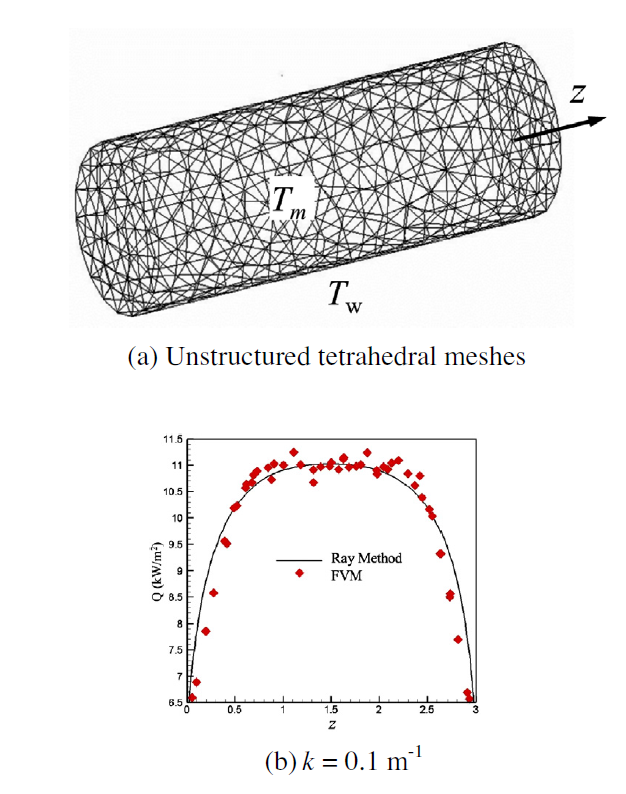

Attached is an image of the heat flux distribution for this case from a published paper.

Air inside the cavity is stationary. So, I turned off the flow equations, and solved only energy and DO equations. Once the steady state conditions are reached, the temperature inside the cavity became 300K, because of the heat transfer from the hot air to the wall. As a result of the heat transfer, the air inside the cavity cools down, and reaches the wall temperature when steady state conditions are reached.
I tried another approach. I solved the DO equation first (without flow and energy equations). Then turned on the energy equation, and solved both the equations in transient mode with a very small time step (1.0E-07 seconds) for one time step. The goal is to estimate the heat transfer rate at the first time step, before a lot of energy being transferred to the wall. Attached is an image of the predicted heat transfer rate to the wall. This results matches well with the published data.
