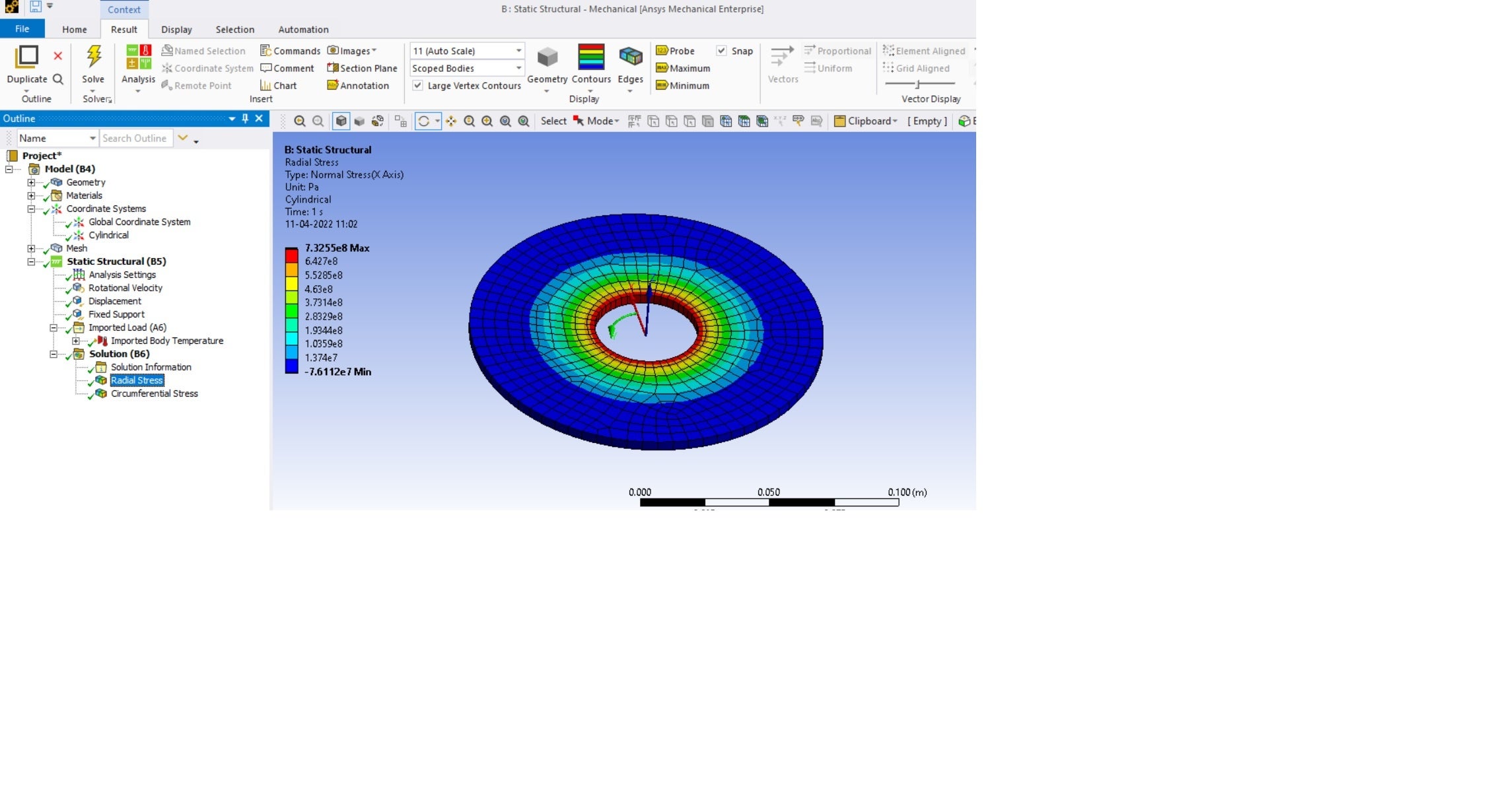

Normal stress along tangential and radial directions implies hoop and radial stress.
Regards Ashish Khemka
April 22, 2022 at 10:37 amShanky_Shank

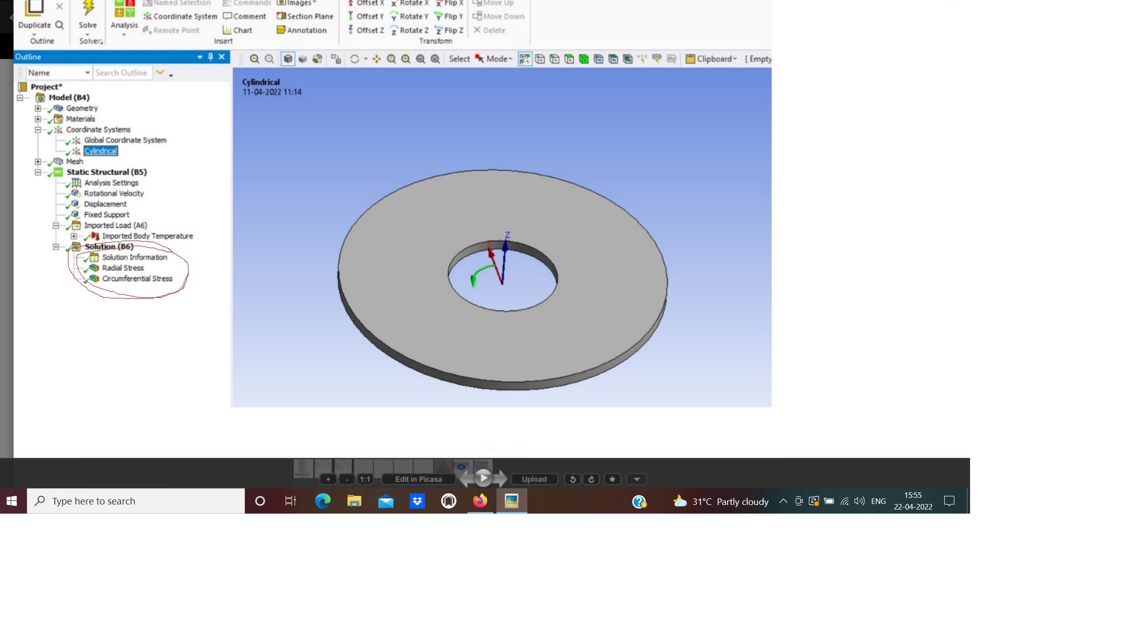

SubscriberHello sir Thanks for your reply..I had done the same thing..I applied a cylindrical coordinate system..and the apply normal stress along tangential and radial direction to get hoop stress and radial stress..Can you please help me the rotation part, do i need to apply revolute joint or any other methods? as you can see in the attached photo..
