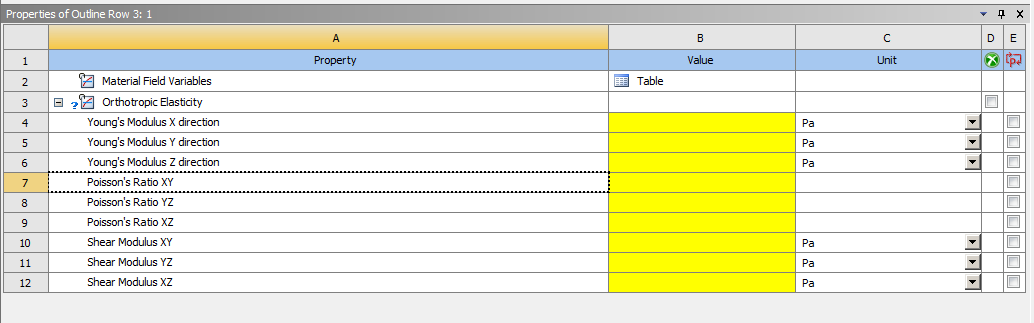

      Dear Community,
      Just a quick question about material definition inWB
      As shown below, I am wondering the poisson ratios input in WB are in terms of major poisson ratios or minor poisson ratios?
      Or it strictly follows the order the how x,y and z is arranged. Assume x is the strongest material axis, then Poisson Ratio xy is major, and YZ is major one as well, XZ is also major. Is my understanding correct?
      Thank you!
    • ashish.khemka
      Yes, the entries are major Poisson's ratio.
      Ashish Khemka
      • wancheng gao
        Hello Ashish, appreciate you answered my second question in this post and thank you for your time!
        I am still confused about the MP entries here. What if the z axis is the strongest material axis? If so, isn't it poisson ratio yz and xz minor ones?
        Or say it can only assume in WB MP entries that x is the strongest and not allowed for other axes to be the strongest ones?
        Thank you for your help!
        Kind regards!
