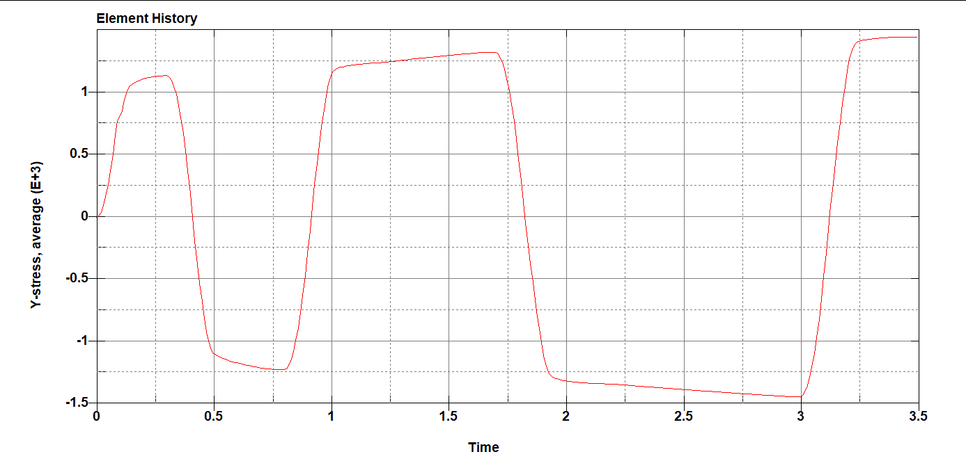

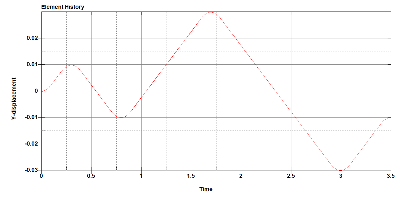

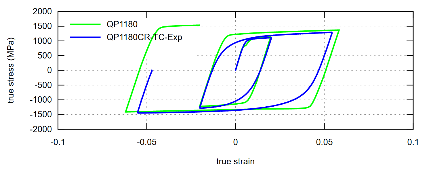

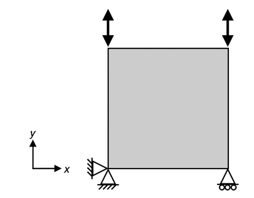

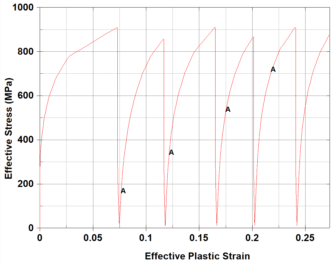

SubscriberI am currently learing about Bauschinger effect in sheet metal forming. A one-element tension and compression is performed to plot the strain-stress curve of QP1180 sheet metal. To take Bauschinger effect into consideration, I used MAT_125 and Bao Steel QP1180 from the MatDB. However, the result didn't seem to reveal the Bauschinger effect and during the initial tension, the stress curve showed a stange twist. I wonder what going on. I'll be very appreciate if anyone can help.Â
The boundary condition and result are listed in the pictures below.

Ansys EmployeeHi,

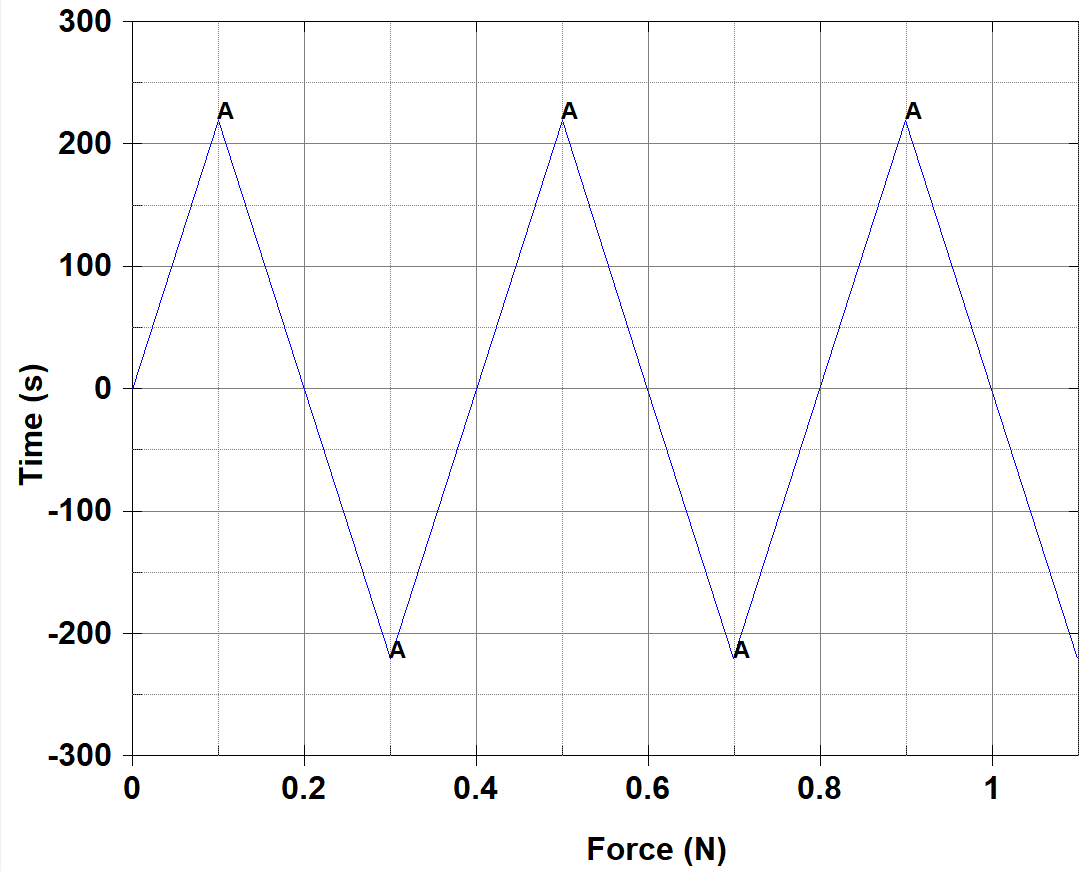

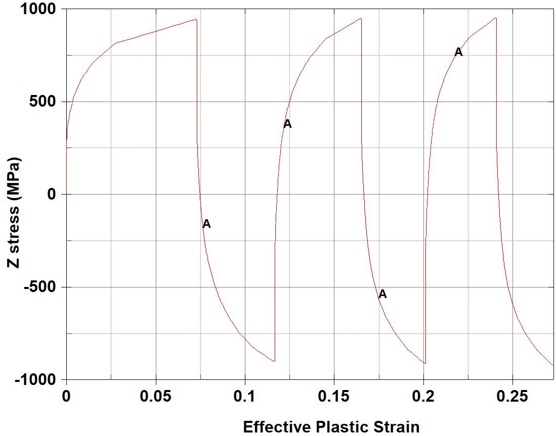

I created a simple cube tensile model using *MAT_125 in LS-DYNA and applied forward and reverse loading along the z-axis based on the trend shown below. The Bauschinger effect seems to be captured in the predictions.Â
Input Loading History:Output Stresses:
You might have the solver issue. Please try the latest versions.Â
