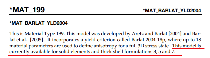

Subscriber Dear LS-DYNA Support Team, I hope you are doing well.
I would like to ask whether the yield locus model **YLD2004-18p** can be applied to **shell elements** in LS-DYNA.
Could you please let me know if this material model is supported for shell formulations, and if there are any specific limitations or requirements that need to be considered?
Thank you very much for your support.

Hi,Â
MAT_199_YLD2004 captures the yield criterion where up to 18 material parameters define anisotropy for a 3D stress state.
This model is currently available for solid elements and thick shell formulations 3, 5, and 7.Â
Cheers, Ram
