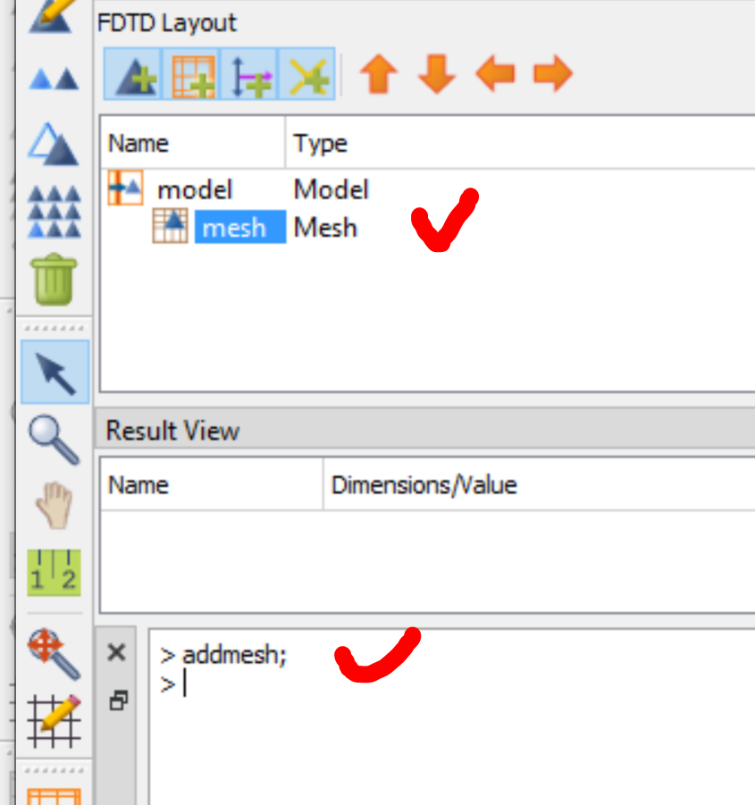

      Im just getting started with FDTD and im trying to follow the tutorials on the website, however, when I click on the button to add a mesh override region nothing happens. Are there some dependencies I might be missing or is the problem somewhere else?
    • Guilin Sun
      Thank you for bring this issue. I tested and found it is a bug.
      Please use script at this moment:
      addmesh
      in the prompt:
    • Lito
      @Joe Francis, Upgrade to the latest Lumerical 2022 R2.4 release which fixes this issue with the mesh.
