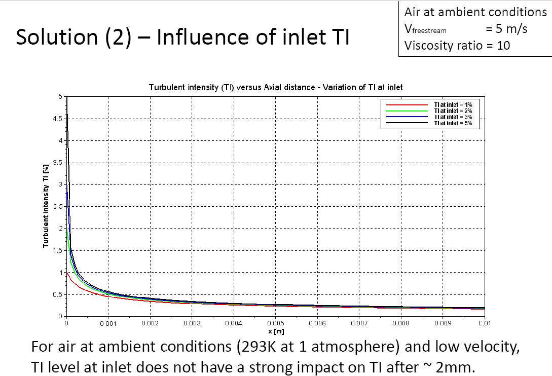

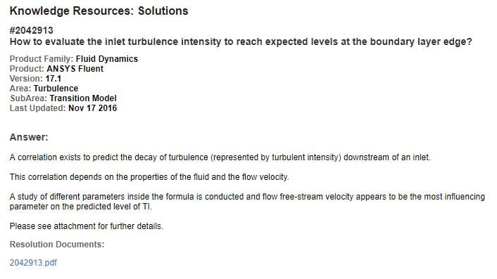

I would like to predict the decay of turbulence intensity downstream of an inlet. In this way, I could apply a correct turbulence intensity at the inlet in order to get the expected value at the location of interest. The following equation is provided in ANSYS Custom Portal under Solution #2042913.
I have the following questions about this equation:
1. The unit of the equation is not included. Could you please let me know the unit of this equation?
2. Is ρ the air density and can be set as 1.225 kg/m^3 at standard atmospheric pressure assuming the equation is in SI unit?
3. Is μ the dynamic viscosity and can be set as 1.81e-5 Pa•s?
4. In the denominator, does μ(μt/μ) mean μ multiply μt/μ? μt/μ represents eddy viscosity ratio?

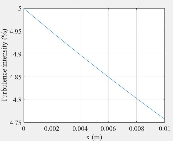

I used the equation and above parameters to do the calculation, but I get different results from the provided solution, which is also attached. That's why I made these questions. Could you please give me some suggestions?
This is what I got. The turbulence intensity at inlet is set to 0.5%. The V at freestream is 5 m/s and viscosity ratio is 10.
This is the comparing case from ANSYS Custom portal.
For your convenience, the MatLab code I used for the calculation is copied here.

December 20, 2018 at 5:17 pm
DrAmine
Ansys EmployeeDo you have access to customer portal? -
December 20, 2018 at 5:21 pm
mutianzi1
SubscriberHello Amine,
I do not have the access to customer portal.
My advisor can access the customer portal and she gave me this information.
Thank you!
December 20, 2018 at 5:29 pm
DrAmine
Ansys EmployeeTi is dimensless. The material properties are specified at ambient conditions as highlighted in the solution. You need to adjust them to your local conditions. Mu_t to Mu is the viscosity ratio. -
