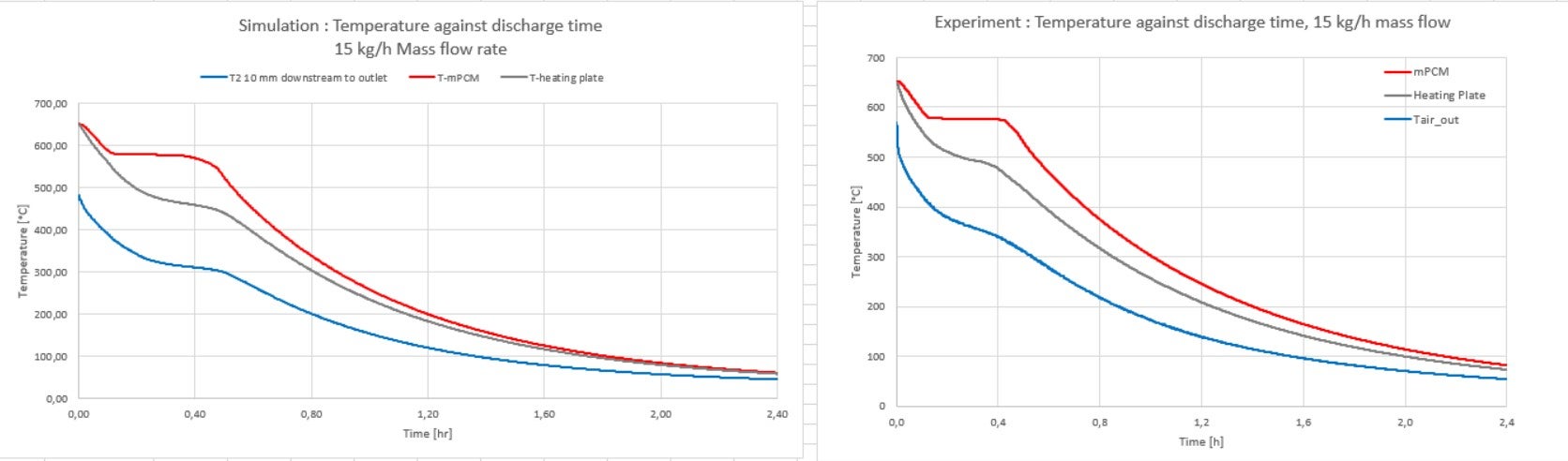

      The simulation works but the temperature curve of the PCM (see image - red curve) at the end of solidification shows a gradual change, whereas in reality the temperature changes steeply upon reaching the solidus temperature.

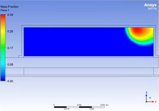

      The reason is that there are liquid portions in the PCM volume even upto 20°C below the solidus temperature. Below is a contour of the PCM mass fraction at 555°C (15°C below the solidus temperature). Only when the whole volume is solidified, the temperature starts dropping as expected.
      I wish to get the liquid fraction to zero closer to the solidus temperature and see a temperature curve similar to the experiment. I've tried the following so far.
      1. Reducing the solidus temperature to check if there is some additional latent heat stored. Makes no difference.
      2. Tried the following values for the mushy zone parameter, A_mush : 10^5, 10^4, 10^6,10^8. No effect on temperature curve (but affects flow convergence).
      3. Delaying the increase of contact resistances after solidification.
      4. Changing the temperature at which the specific heat capacity and thermal conductivity of the PCM change sharply (tried setting them to liquidus temperature and solidus temperature)
      5. Mesh is converged. I've run this with a million more cells and same result.
      6. Tried setting density of PCM to value at initial temperature and also with average value over temperature range.
      Some more details about the method:
      Laminar model, double-precision enabled, second order bounded implicit transient formulation, Coupled pressure-velocity solver, Second order accuracy for pressure, momentum and energy.
      With time step size 1s, I run it for first 5-10 time steps. I'm getting good convergence of solution (1e-6 for continuity, momentum and 1e-12 for energy). Thereafter, I use a time step size of 10s.
      Note:  The contact resistances are still to be adjusted. Therefore, the time of heat discharge differs from the experiment.
      Which parameter or property controls the range in which the liquid fraction changes from 1 to 0?
