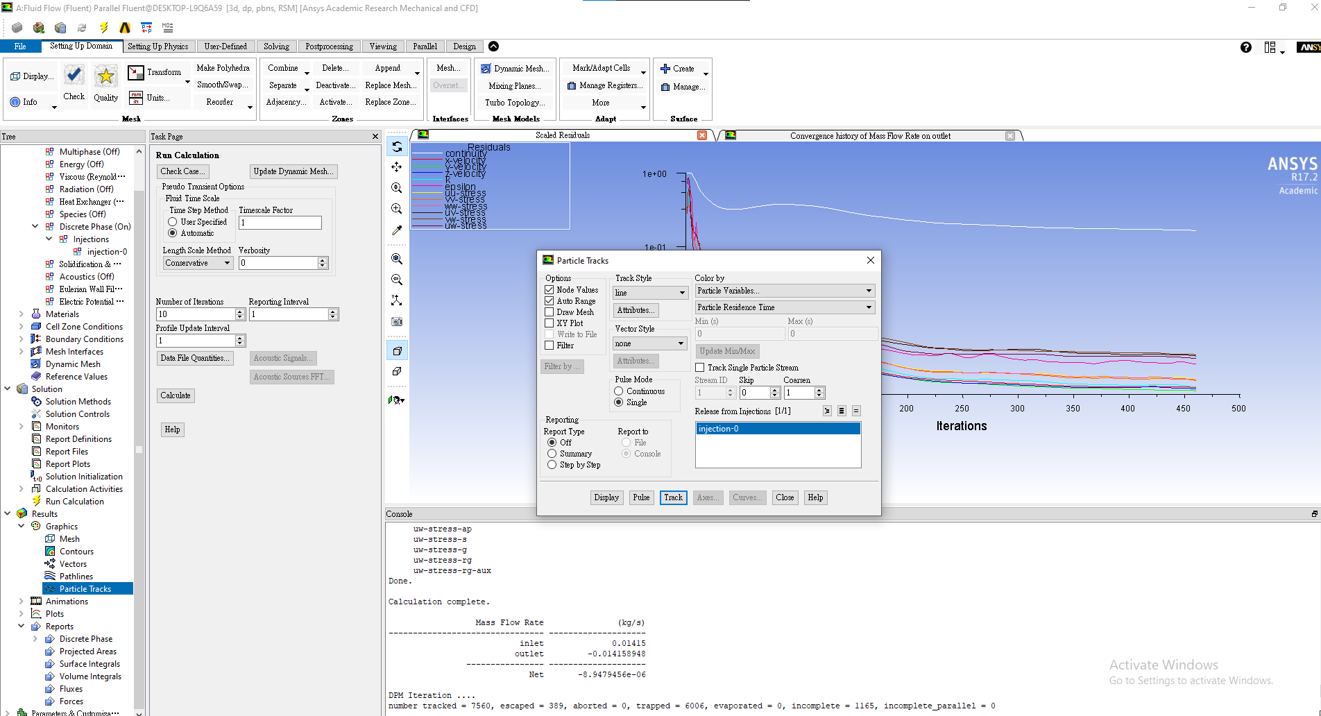

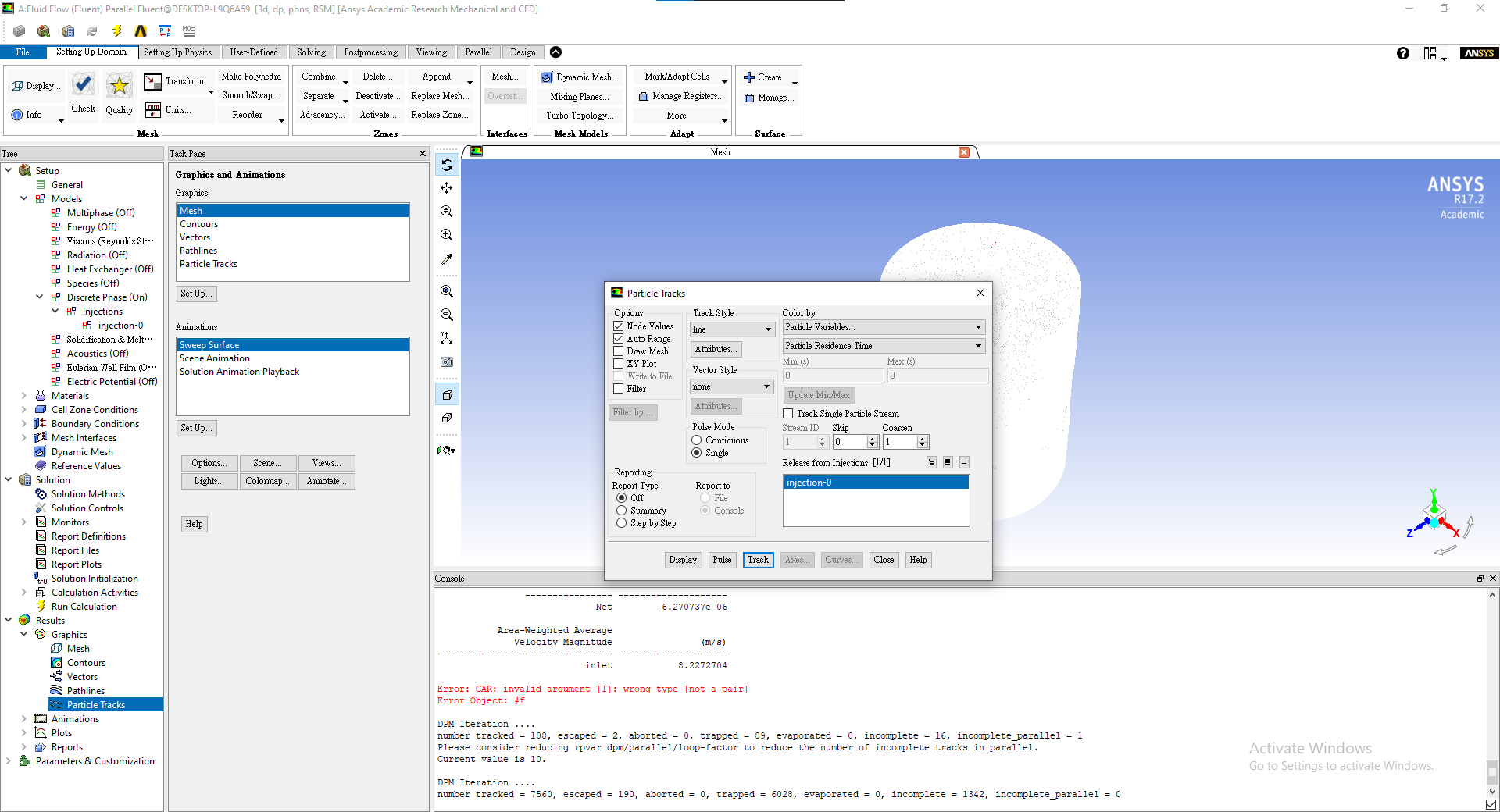

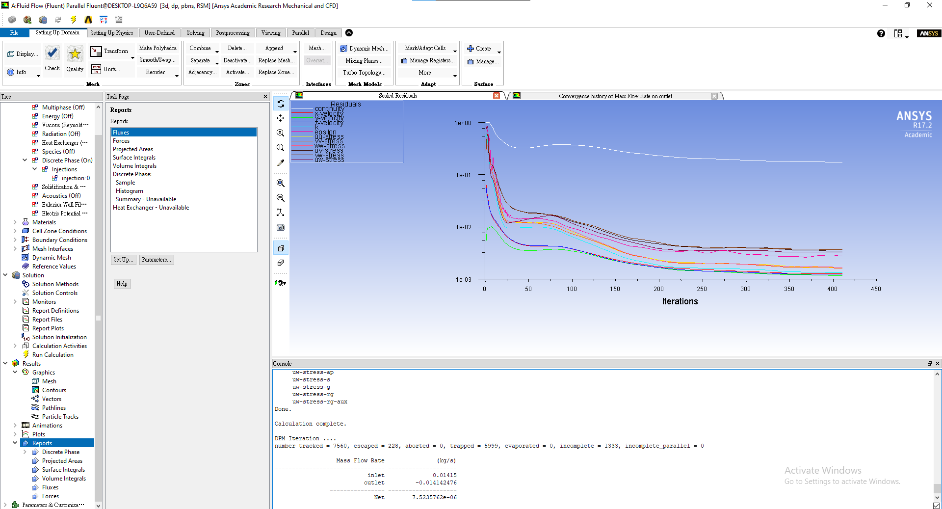

SubscriberHi,I am using ansys fluent to analyze the oil seperation in the compressor.
I saw the DPM iterations result have different value when I choose to let it run different iterations.
It is very different when it runs 400,410 or 460 iterations.
I am so comfused which one is right or what should I set is the best.

Ansys EmployeeHi: Your flow hasn't converged yet. You can get a converged flow and then do the DPM calculation.

SubscriberHi Prashanth!Thanks for your replay.
I ask the coverged standard before.
Here is my post : /forum/forums/topic/how-to-know-that-the-simulation-has-reached-convergence/
And the curve in the pictures is seems like no float anymore.The coverged standard confuses me.????
