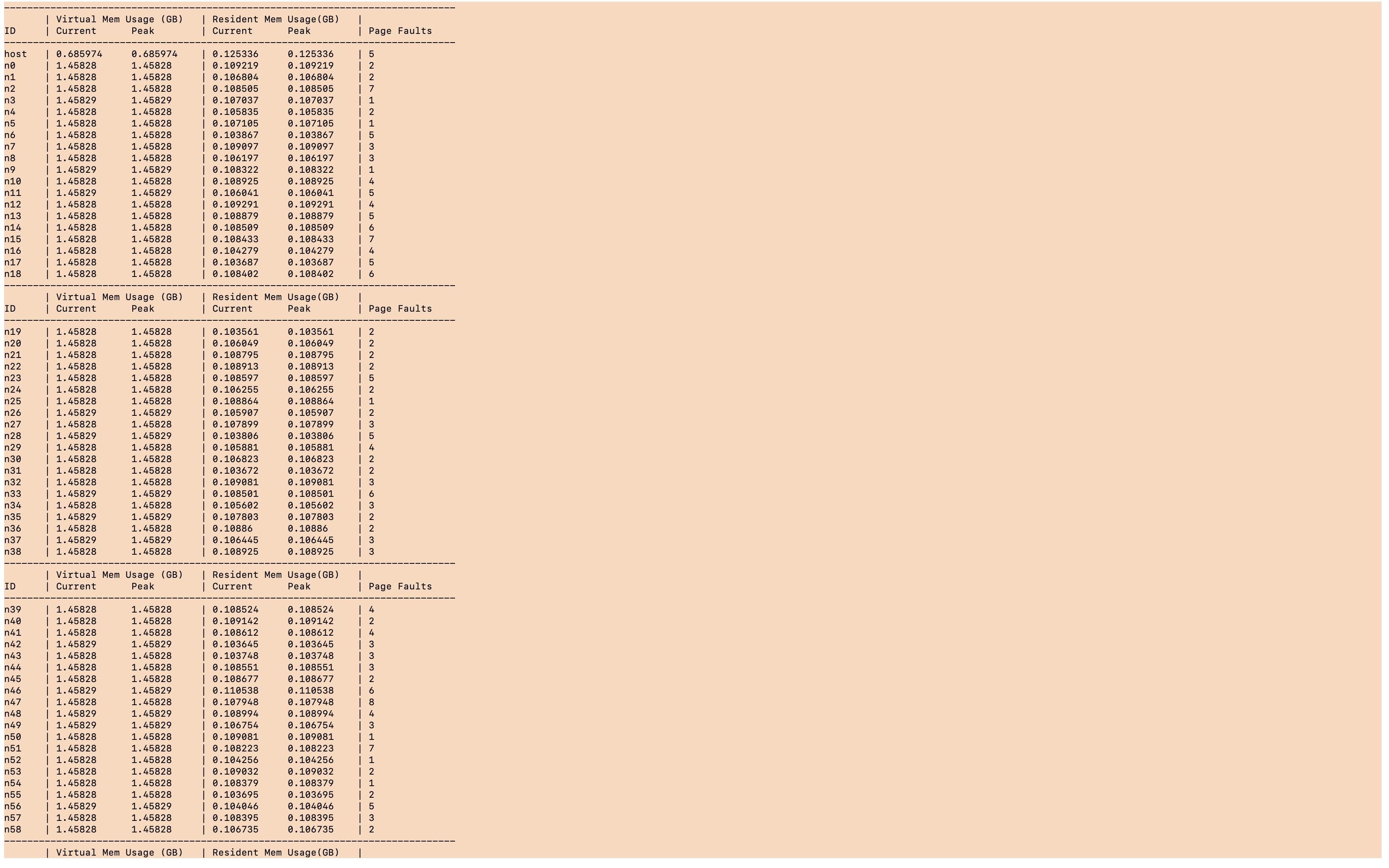

SubscriberRunning fluent on a large cluster results in the following outfile section with The ID hostname Core PID etc..
ID   Hostname      Core  O.S.   PID      Vendor
n0-67 c455-051.xx.t 68/272 Linux-64 151468-151535 Intel(R) Xeon Phi(TM) 7250
host  c455-051xx.t     Linux-64 148637     Intel(R) Xeon Phi(TM) 7250
MPI Option Selected: intel
Selected system interconnect: mpi-auto-selected
I am used to seeing this section in the following way:
#example parallelization 16 cores:Â
ID Hostname Core OS PID VendorÂ
n##. XX. 1/16 X. ##. XXÂ
n##. XX. 2/16 X. ##. XXÂ
n##. XX. 3/16 X. ##. XXÂ
n##. XX. 4/16 X. ##. XXÂ
and so on...
While the ID n0-67 and the PID 151468-151535 point to 68 parallel subprocesses being created (as requested) It seems like they are all assigned to a single node 68/272. Is this an incorrect assumption on my part and is the process actually being divided across 68 cores are well ?
Any help would be appreciated. Thank you.

PROC-STATS:
| Virtual Mem Usage (GB) | Resident Mem Usage(GB) |
ID | CurrentPeak| CurrentPeak| Page Faults
host | 0.685974 0.685974| 0.125336 0.125336| 5
n0 | 1.458281.45828 | 0.109219 0.109219| 2
n1 | 1.458281.45828 | 0.106804 0.106804| 2
n2 | 1.458281.45828 | 0.108505 0.108505| 7
n3 | 1.458291.45829 | 0.107037 0.107037| 1
n4 | 1.458281.45828 | 0.105835 0.105835| 2
n5 | 1.458281.45828 | 0.107105 0.107105| 1
n6 | 1.458281.45828 | 0.103867 0.103867| 5
n7 | 1.458281.45828 | 0.109097 0.109097| 3
n8 | 1.458281.45828 | 0.106197 0.106197| 3
n9 | 1.458291.45829 | 0.108322 0.108322| 1
n10| 1.458281.45828 | 0.108925 0.108925| 4
n11| 1.458291.45829 | 0.106041 0.106041| 5
n12| 1.458281.45828 | 0.109291 0.109291| 4
n13| 1.458281.45828 | 0.108879 0.108879| 5
n14| 1.458281.45828 | 0.108509 0.108509| 6
n15| 1.458281.45828 | 0.108433 0.108433| 7
n16| 1.458281.45828 | 0.104279 0.104279| 4
n17| 1.458281.45828 | 0.103687 0.103687| 5
n18| 1.458281.45828 | 0.108402 0.108402| 6
n19| 1.458281.45828 | 0.103561 0.103561| 2
n20| 1.458281.45828 | 0.106049 0.106049| 2
n21| 1.458281.45828 | 0.108795 0.108795| 2
n22| 1.458281.45828 | 0.108913 0.108913| 2
n23| 1.458281.45828 | 0.108597 0.108597| 5
n24| 1.458281.45828 | 0.106255 0.106255| 2
n25| 1.458281.45828 | 0.108864 0.108864| 1
n26| 1.458291.45829 | 0.105907 0.105907| 2
n27| 1.458281.45828 | 0.107899 0.107899| 3
n28| 1.458291.45829 | 0.103806 0.103806| 5
n29| 1.458281.45828 | 0.105881 0.105881| 4
n30| 1.458281.45828 | 0.106823 0.106823| 2
n31| 1.458281.45828 | 0.103672 0.103672| 2
n32| 1.458281.45828 | 0.109081 0.109081| 3
n33| 1.458291.45829 | 0.108501 0.108501| 6
n34| 1.458281.45828 | 0.105602 0.105602| 3
n35| 1.458291.45829 | 0.107803 0.107803| 2
n36| 1.458281.45828 | 0.108860.10886 | 2
n37| 1.458291.45829 | 0.106445 0.106445| 3
n38| 1.458281.45828 | 0.108925 0.108925| 3
n39| 1.458281.45828 | 0.108524 0.108524| 4
n40| 1.458281.45828 | 0.109142 0.109142| 2
n41| 1.458281.45828 | 0.108612 0.108612| 4
n42| 1.458291.45829 | 0.103645 0.103645| 3
n43| 1.458281.45828 | 0.103748 0.103748| 3
n44| 1.458281.45828 | 0.108551 0.108551| 3
n45| 1.458281.45828 | 0.108677 0.108677| 2
n46| 1.458291.45829 | 0.110538 0.110538| 6
n47| 1.458281.45828 | 0.107948 0.107948| 8
n48| 1.458291.45829 | 0.108994 0.108994| 4
n49| 1.458291.45829 | 0.106754 0.106754| 3
n50| 1.458281.45828 | 0.109081 0.109081| 1
n51| 1.458281.45828 | 0.108223 0.108223| 7
n52| 1.458281.45828 | 0.104256 0.104256| 1
n53| 1.458281.45828 | 0.109032 0.109032| 2
n54| 1.458281.45828 | 0.108379 0.108379| 1
n55| 1.458281.45828 | 0.103695 0.103695| 2
n56| 1.458291.45829 | 0.104046 0.104046| 5
n57| 1.458281.45828 | 0.108395 0.108395| 3
n58| 1.458281.45828 | 0.106735 0.106735| 2
n59| 1.458281.45828 | 0.108227 0.108227| 2
n60| 1.458281.45828 | 0.106087 0.106087| 1
n61| 1.458281.45828 | 0.108635 0.108635| 2
n62| 1.458281.45828 | 0.108311 0.108311| 2
n63| 1.458281.45828 | 0.106277 0.106277| 6
n64| 1.458281.45828 | 0.107216 0.107216| 2
n65| 1.458281.45828 | 0.108475 0.108475| 1
n66| 1.458281.45828 | 0.107117 0.107117| 1
n67| 1.458291.45829 | 0.106918 0.106918| 2

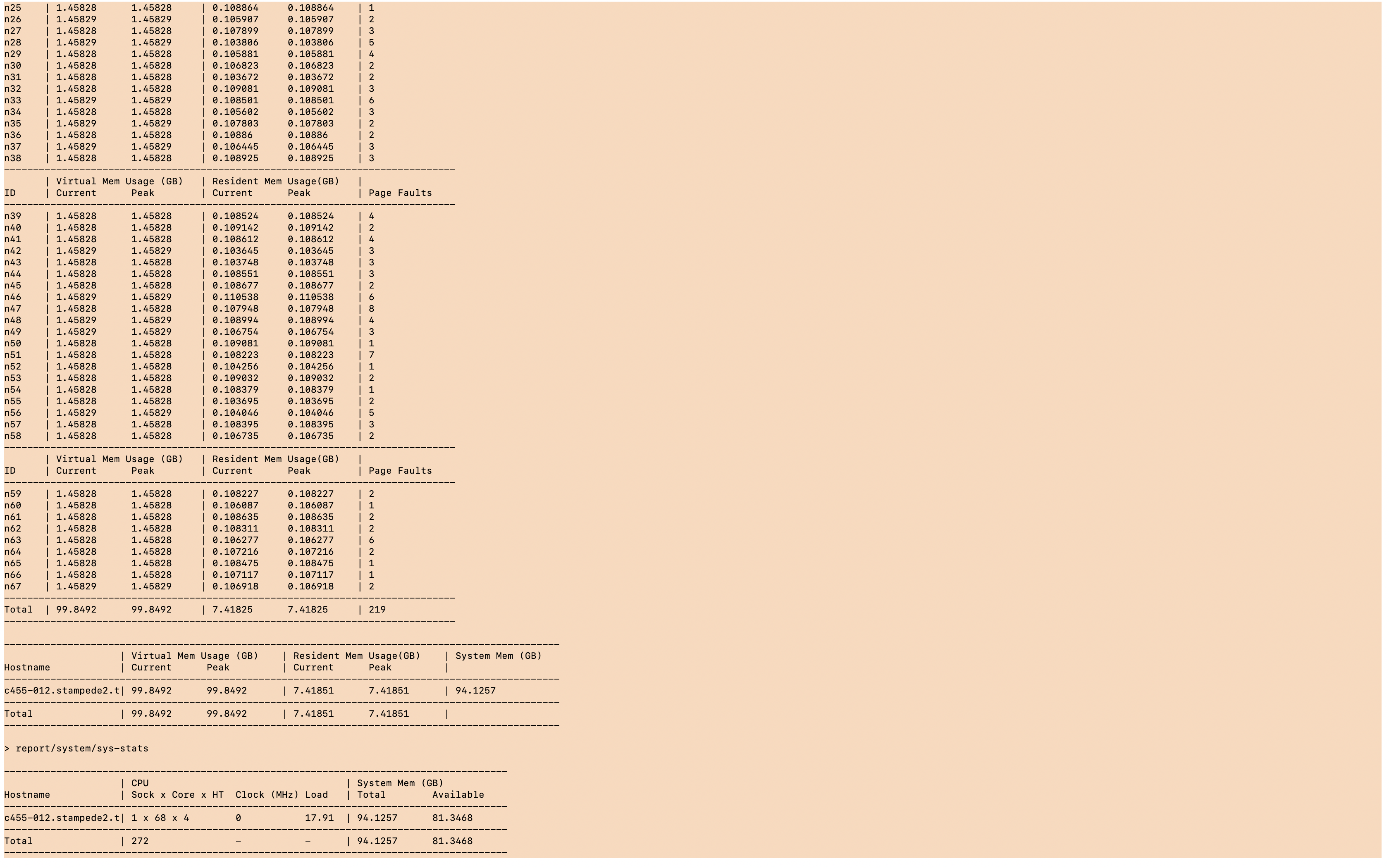

Total| 99.849299.8492 | 7.418257.41825 | 219
| Virtual Mem Usage (GB)| Resident Mem Usage(GB)| System Mem (GB)
Hostname| CurrentPeak | CurrentPeak |
c455-012.xx.t| 99.849299.8492| 7.418517.41851| 94.1257
Total | 99.849299.8492| 7.418517.41851|
SYS_STATS:
| CPU | System Mem (GB)
Hostname| Sock x Core x HTClock (MHz) Load | TotalAvailable
c455-012.xx.t| 1 x 68 x 40 17.91| 94.125781.3468
Total | 272 - -| 94.125781.3468

May 20, 2022 at 9:54 amcviveknair
SubscriberPROC-STATS:
SYS_STATS:
