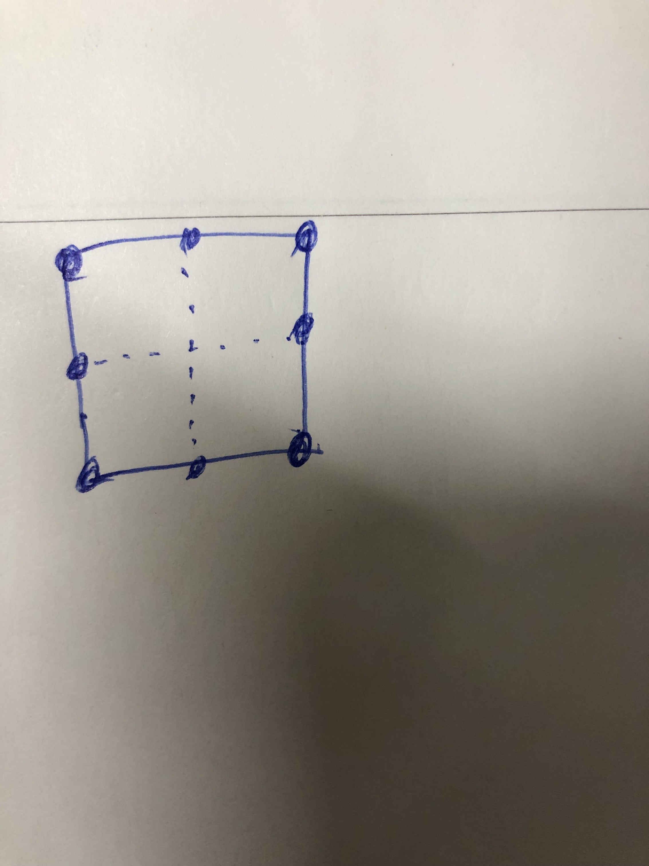

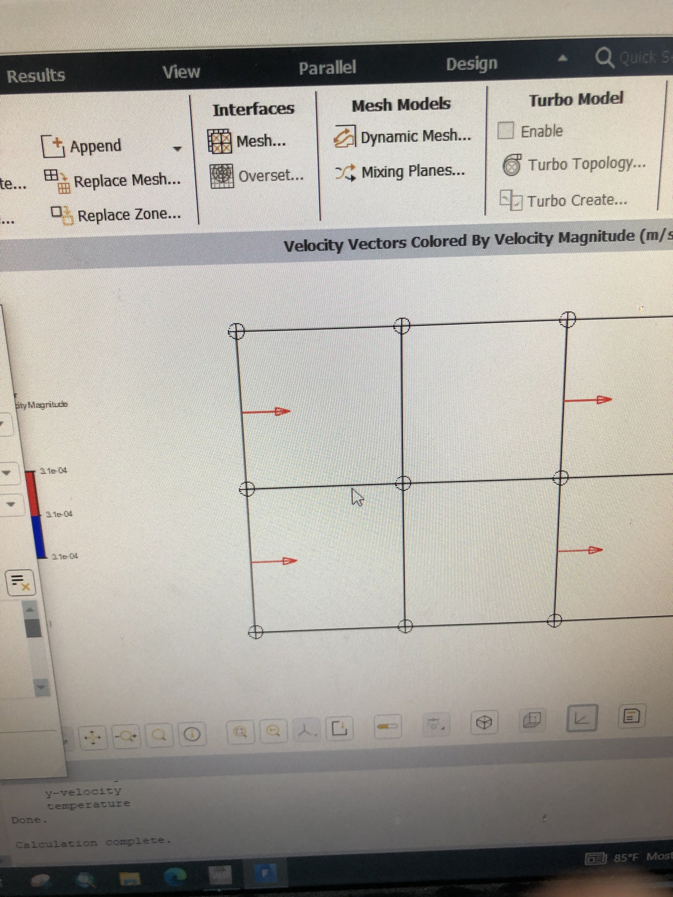

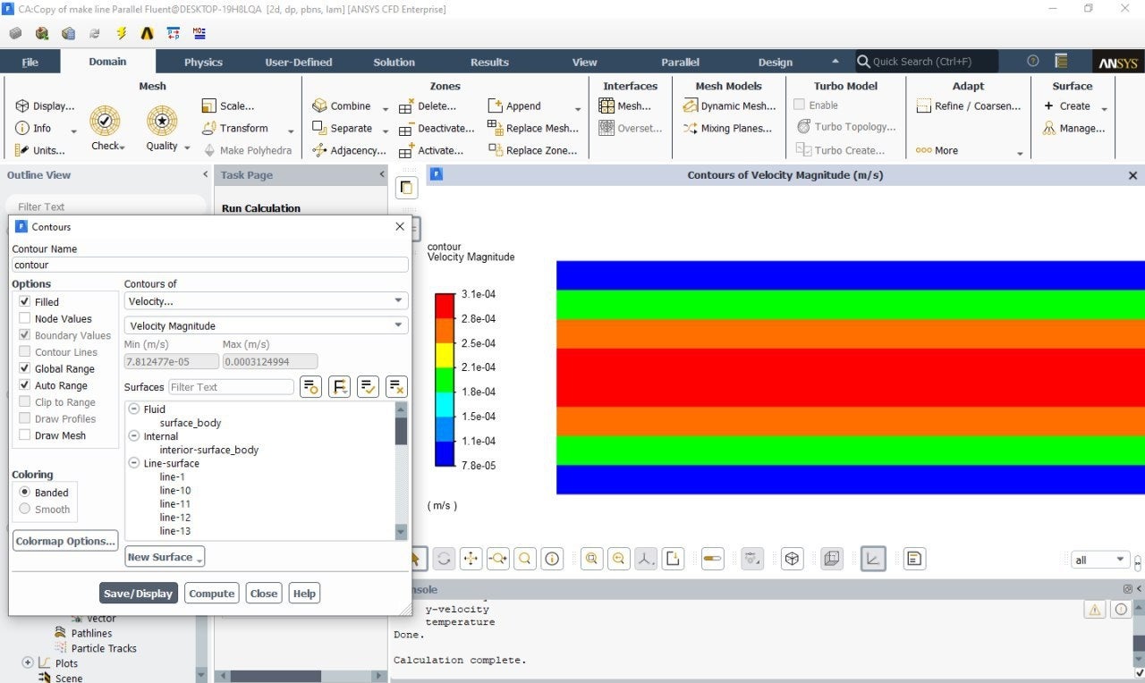

SubscriberHello everyone,
I make the mesh with the quadratic element order. But I check the value of velocity after I run the calculation, it seems that my mesh is linear element order.
you can check the picture below.
My regards,
P. Heng.

September 19, 2021 at 7:13 amSeptember 20, 2021 at 9:59 amRob
Forum ModeratorFluent uses the cell centre so only takes the cell shape from Meshing: you have a zero velocity on the wall and two flow values. As with your other models you need more mesh: repeat the test with 10 cells across the channel.

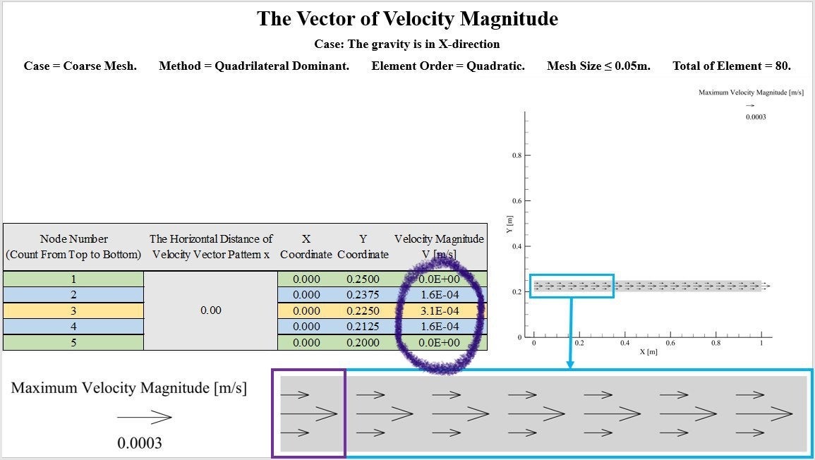

September 21, 2021 at 2:43 amP_Heng
I add more meshes or not, the results show that they are linear, not quadratic. As you see in the picture.
You can see this result:
V = 1.6E-04 and V = 3.1E-04
this result shows that this is linear.
V = 1.6E-04 should be greater than 2E-04 ( hand calculation).
My prof. doesnÔÇÖt accept it.
My regards.
P. Heng.
September 21, 2021 at 12:54 pmRob
Forum ModeratorRun with a good mesh: ie inflation and 10 or so nodes across the channel. It's linear as you currently have too few data points for it to be anything but.

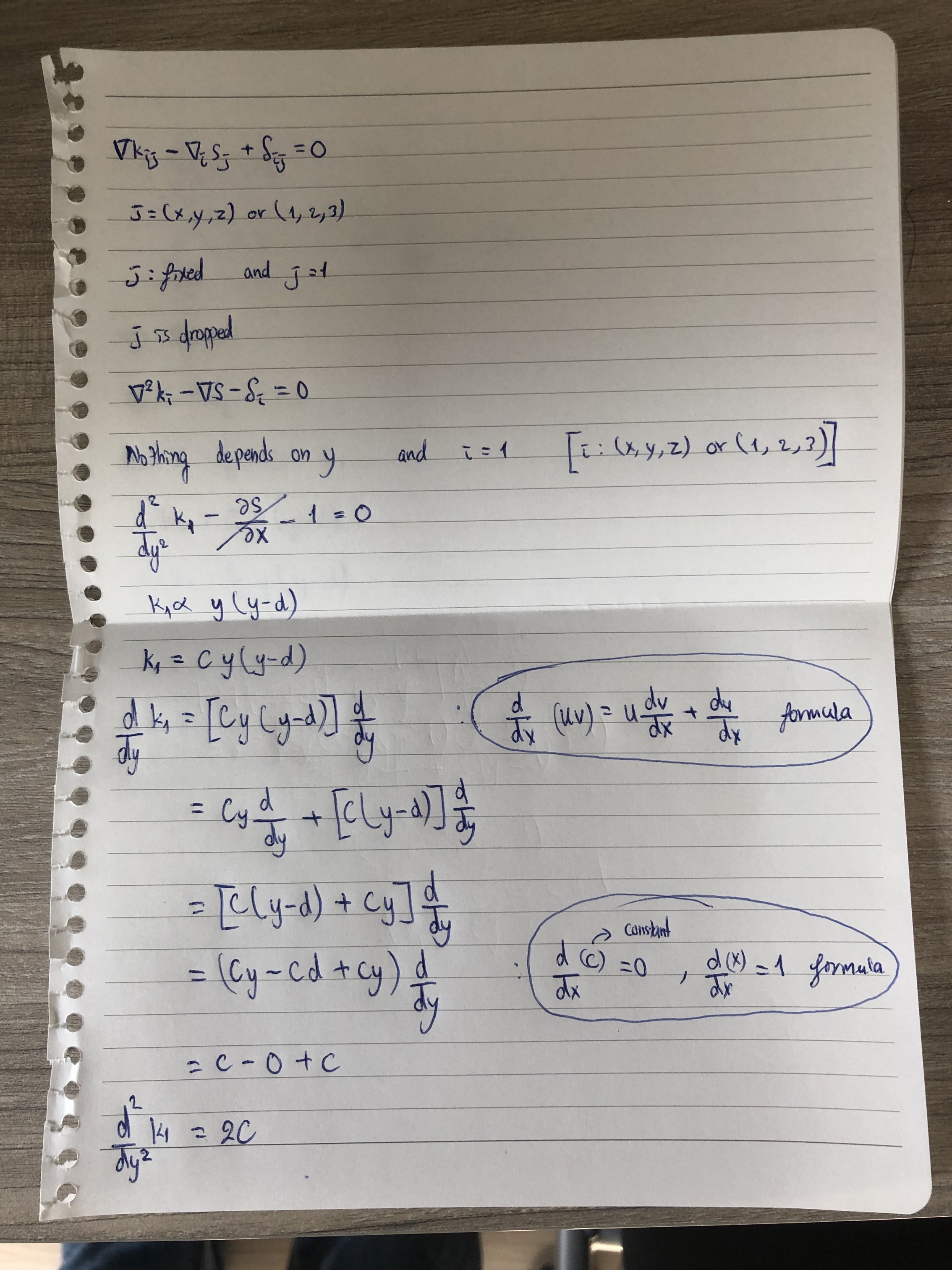

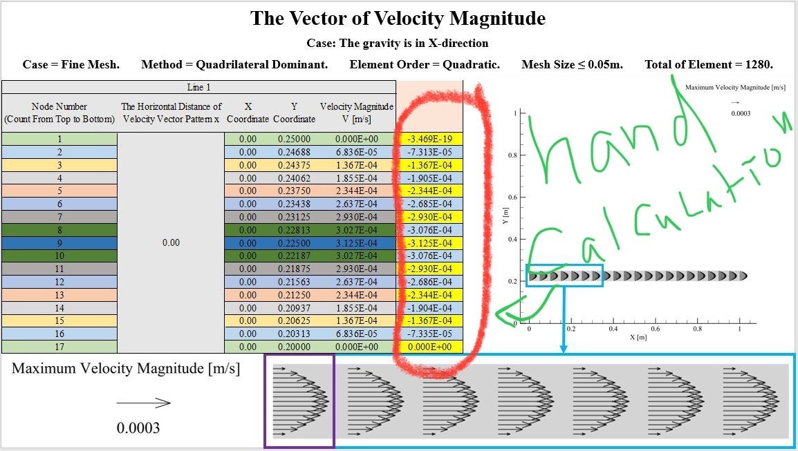

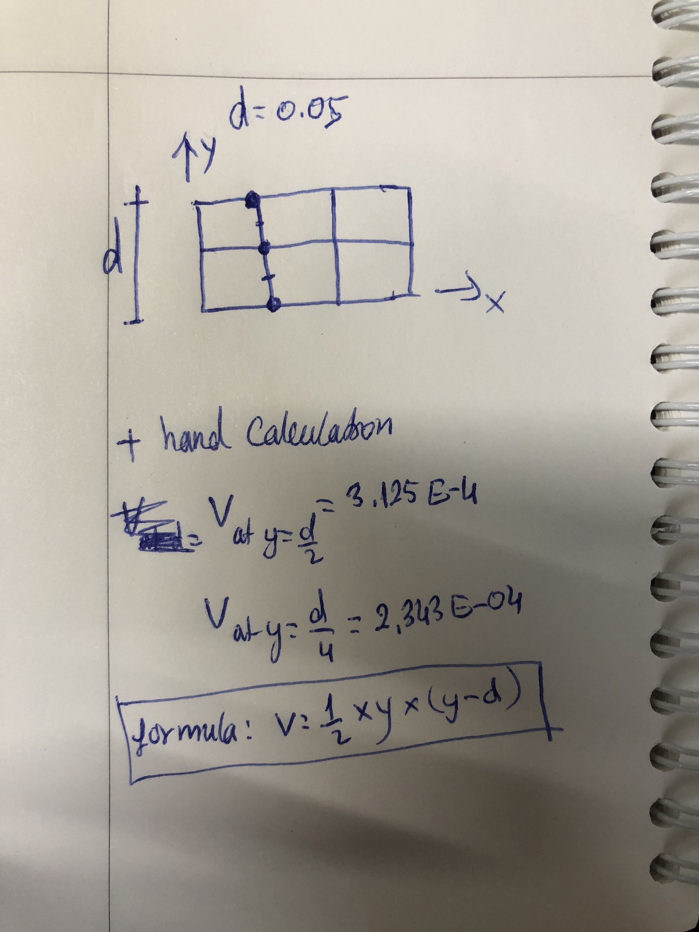

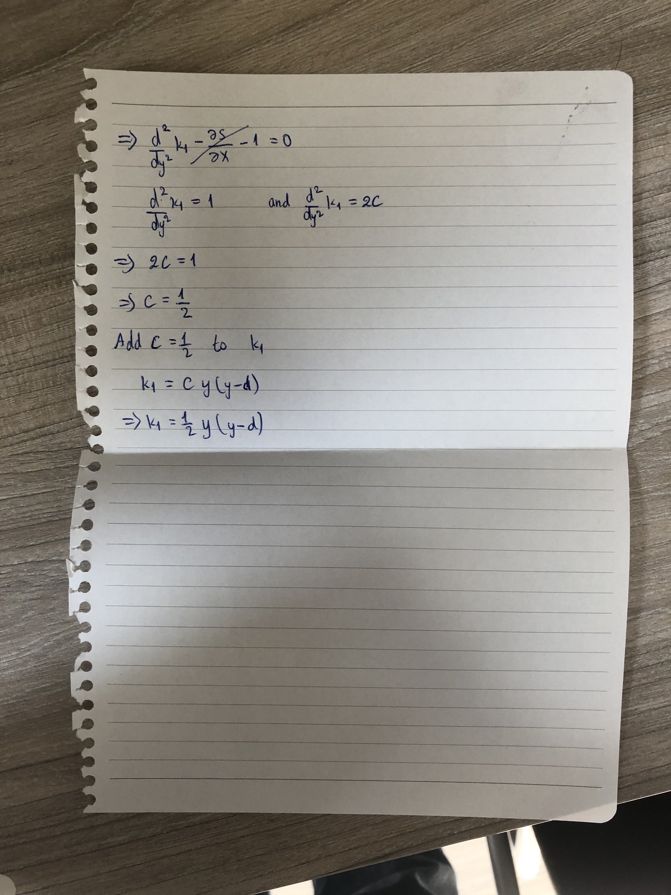

September 23, 2021 at 2:01 amP_Heng
I am doing for four case of mesh, coarse mesh, medium mesh, fine mesh, and finer mesh.
In fine mesh and finer mesh, I see the velocity vector with parabolic shape.
The problem is that the value in the middle side of cell is different to my hand calculation. The value on the edge node of cell, they are right with my hand calculation. You send you the formula:
k1 is velocity.
k1 = 1/2 y (y - d)
My regards P. Heng.
September 24, 2021 at 8:39 amRob
Forum ModeratorHow different? Is the centre of the domain a mesh cell, or does it fall at a cell boundary?
September 24, 2021 at 12:57 pmP_Heng
As you see the picture, the velocity is equal to 1.6E-04, should be equal to 2.34E-04 (according to the hand calculation above).
if it is equal to 1.6E-04, it seems that I use linear element because you the shape of the vector is not look like parabolic shape.
I use quadratic element.
My regards P. Heng.
September 24, 2021 at 1:09 pmRob
Forum ModeratorIn the fine mesh what is the result? Please show the contours of velocity (node values off) too.

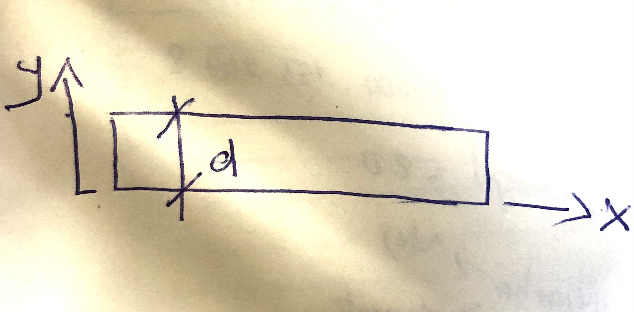

September 27, 2021 at 9:41 amRob
Forum ModeratorIs the graph & table the hand calc and the lower image Fluent with 8 cells across the channel? What's the y+ like?
September 28, 2021 at 1:54 amP_Heng
both pictures above, I use quadratic mesh but the result is like I am using linear mesh. For the hand calculation, I use the formula above to calculate it and it is given by my prof.
Sorry Rob, I donÔÇÖt know y+. What is it? Can you explain me?
My regards P. Heng.
September 28, 2021 at 10:22 amRob
Forum ModeratorA quad mesh in Fluent means the cells are square-ish. The profile is then a function of the flow and whether you've resolved it.

September 29, 2021 at 12:19 pmRob
Forum ModeratorWith the exception of the cell that's adjacent to the wall you're within around 1% : do you really expect to get an exact agreement with the theoretical calculation? Have you used exactly the same density, viscosity values etc?
Re the number of nodes on a 2d hex (quad) element. Read how CFD (Fluent) uses cells, and then read how Mechanical makes use of mid-side nodes.

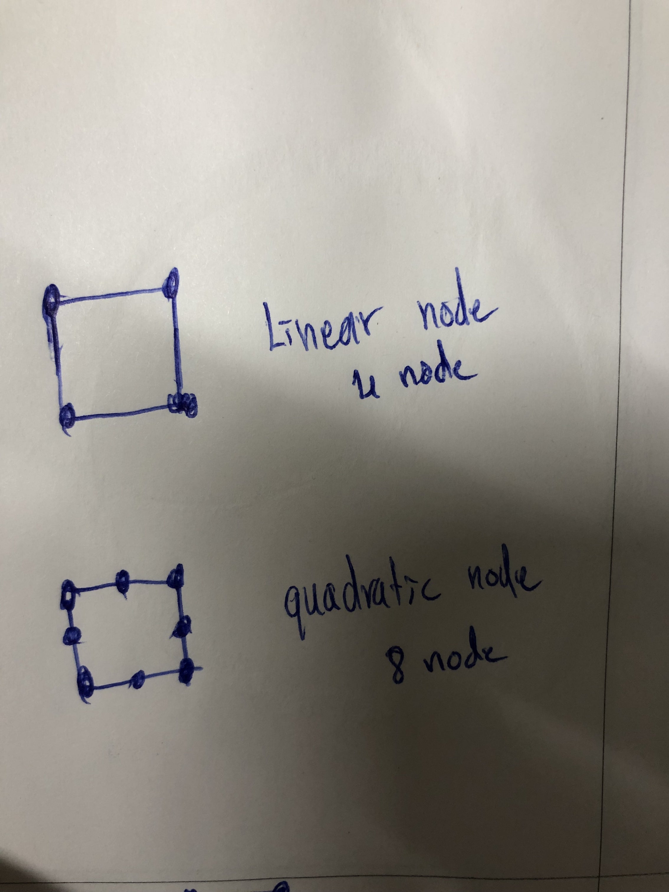

September 30, 2021 at 3:53 pmP_Heng
Thank you, Rob, for your response.
I want to know more that.
How does Ansys Fluent do the calculation with finite element?
Now, talking about 1 element only.
if we use the linear element, 4 nodes, for the mesh, the software should use the whole element to calculate. Is it right?
if we use the quadratic element, 8 nodes, for the mesh, does the software use the whole element to calculate or the software separate a element into 4 parts and then start to calculate because it has 8 nodes? (See picture below)
I hard to explain you in English, I am sorry. I hope you understand me.
My regards P. Heng.
October 1, 2021 at 10:20 amRob
Forum ModeratorI do, and you need to read this https://ansyshelp.ansys.com/account/Secured?returnurl=/Views/Secured/corp/v212/en/flu_th/flu_th_chp_solve.html but also remember that Fluent uses the finite VOLUME method. There are no mid side notes.
