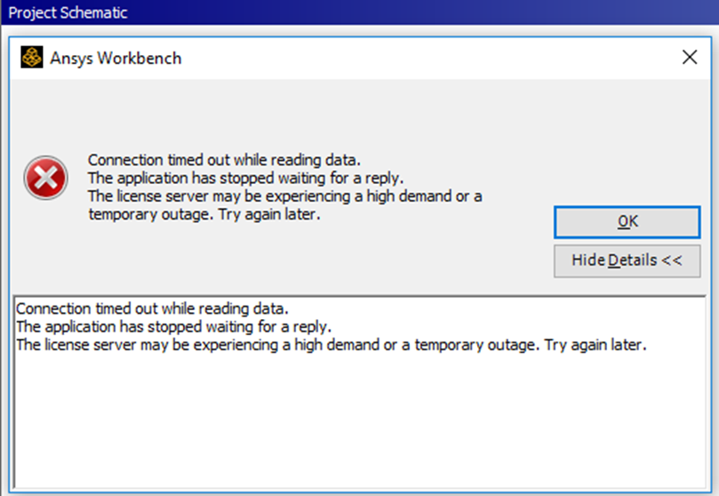

Ansys Employee请设置如下两个环境变量
1. ANSYSCL_TIMEOUT_RESPONSE=300
2. ANSYSCL_TIMEOUT_CONNECT=60
January 4, 2024 at 12:26 am
liqin
Subscriber可以在Hosts文件里边添加License Manager电脑的IP
- 主题 ‘启动Workbench时,提示Connection timed out while reading data,’ 已关闭新回复.
