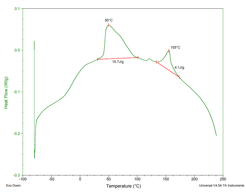

March 14, 2021 at 7:17 pm
michutorres
SubscriberHi,nPure Solvent Melting Heat requires [j/kg]. nThe next picture shows the melting phase of an adhesive (15'7 J/g + 4'1 J/g = 19'8 J/g = 19.800 J/kg). nHowever, I watched many videos on youtube where Pure Solvent Melting Heat are around 190.000 J/kg.nDo you think 19.800 J/kg could be a correct value?nThank youn
n
March 14, 2021 at 10:44 pm
YasserSelima
Subscriber19.8 J/kg seems very lown -
March 15, 2021 at 7:13 am
michutorres
SubscriberIt is not 19.8 J/kg. nit is 19.8 J/g that equals to 19800 J/kg.nis 19800 J/kg very low?n -
March 15, 2021 at 12:15 pm
Rob
Forum ModeratorHard to say, I'm also not sure why you've taken that data off that graph. n -
March 15, 2021 at 12:34 pm
michutorres
SubscriberI have taken that data off that graph because I need to introduce the Pure Solvent Melting Heat (J/kg) to simulate the melting of an adhesive.nDo you think 19800 J/kg is too low?n -
March 15, 2021 at 2:51 pm
DrAmine
Ansys EmployeeDo you know the material? Water which is known to be a very anomalous material has high value of 333.55 J/g (STP)n -
March 15, 2021 at 3:15 pm
michutorres
SubscriberIt is a EVA base adhesive n
