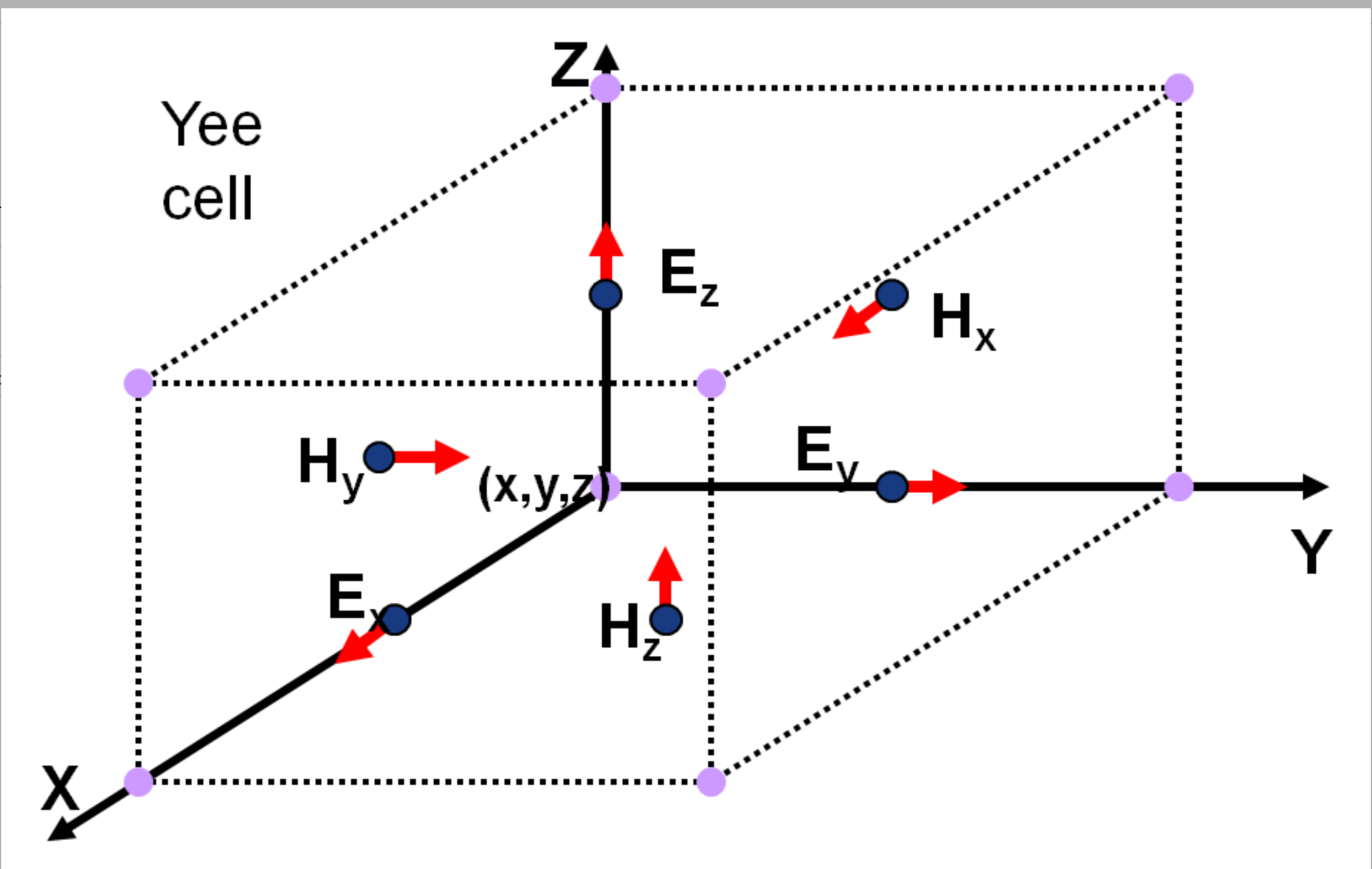

Another thing to take care is: dipole radiated power may be very sensitive to its location in the Yee cell. This is because the 6 components of E and H internally are interleaved:
ideally, the polarized dipole should be located on the correspondent location, eg, Ex polarized dipole should be located at Ex point in Yee cell. In your case, if it is randomly located, the Purcell factor map may not be very smooth.

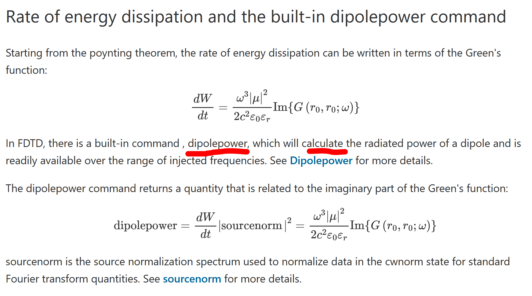

It uses analytical dipolepower : dipolepower - Script command

Yes, it is clear to me that one can use a box of monitors to determine the power emitted from a dipole, and one can use this to calculate the Purcell enhancement. I was just interested in how the dipolepower() command does the same without such a box. I hoped that I could use the same method for some analytical calculations.
I know that the relative phase and amplitude between two sources will affect results quite drastically. As I want to add a third source (left propagating mode, right propagating mode and the dipole), this will lead to a 4 dimensional parameter space (2 relative phases and 2 amplitudes) which I would need to sweep through to see the complete behavior.
That's why I had hoped for an analytical solution, such that I do not need those parameter sweeps. It is linear optics after all, and the docs even mention a method based on Green's function for Purcell factor calculation (https://support.lumerical.com/hc/en-us/articles/360042216834-Greens-function-and-local-density-of-states-of-a-dipole-source). However, they do not really go into detail about how to implement it with Lumerical while not using the dipolepower() command, and I fear that there are also some typos on this page.
