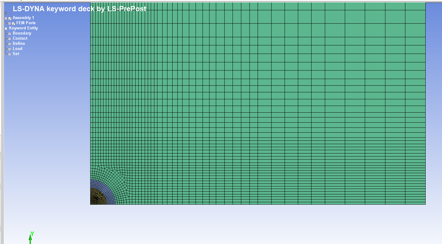

SubscriberI am trying to model a pull out test in ls prepost. The quater model contais of 5 concrete blocks one over the other, a hole which has anchor (bolt). The empty space in the hole around the bolt is filled by grout. the hole is till the half depth of the bottom layer. it takes 300 sec and 150 KN to pull out the bolt. these are the key word cards which I have used for the simulation. i am also attaching the out put file generated.
LS-DYNA keyword deck by LS-PrePost. Am I using the wrong solver I also tried it with implicit the it is showing elapsed time as some days, which is not even reducing.*CONTROL_TERMINATION

How to fix this issue.
